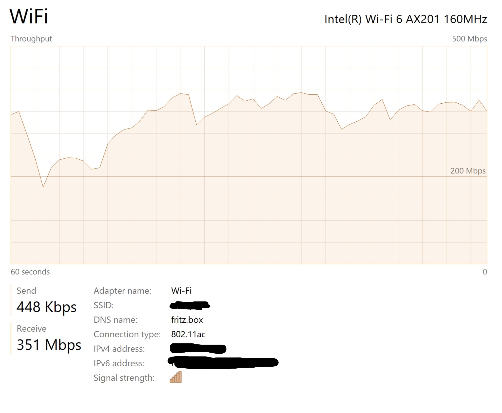

While I do 300-450Mbit/s with my FritzBox, the Mikrotik only reaches 70Mbit.

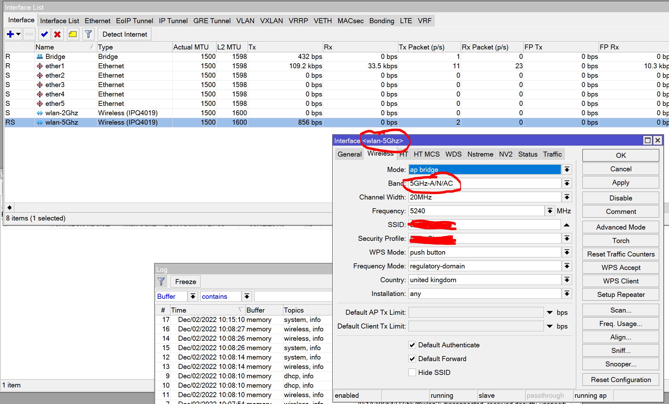

First question, are you sure you actually connected to the 5GHz interface? When device has just started up, it can take up to 5-10 minutes for the devices to verify there are no weather radars in the 5GHz range. You can see the progress when you click on the 5GHz interface in Winbox. 70Mbit sounds like 2GHz is used.
edit
The laptop was connected in 5Ghz with both routers.

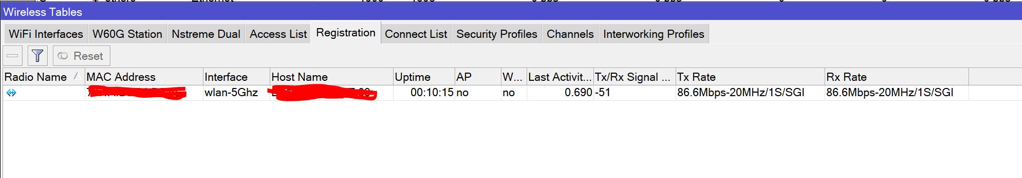

ok but please double check anyway and post the output of the registration table, when the test is being done :smiley:
Hi there
Thanks for your help.

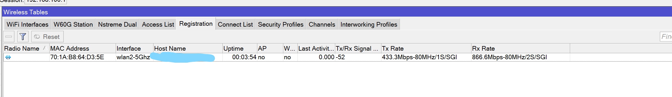

It’s taken me some searching to find out where the “registration table” is and also how to find out when the wireless has finished looking for weather radars! :slight_smile:
10 minutes after powering on the router this is the registration table. I see 86Mbit TX/RX rate which is consistent with my 70Mbit transfers in Windows.

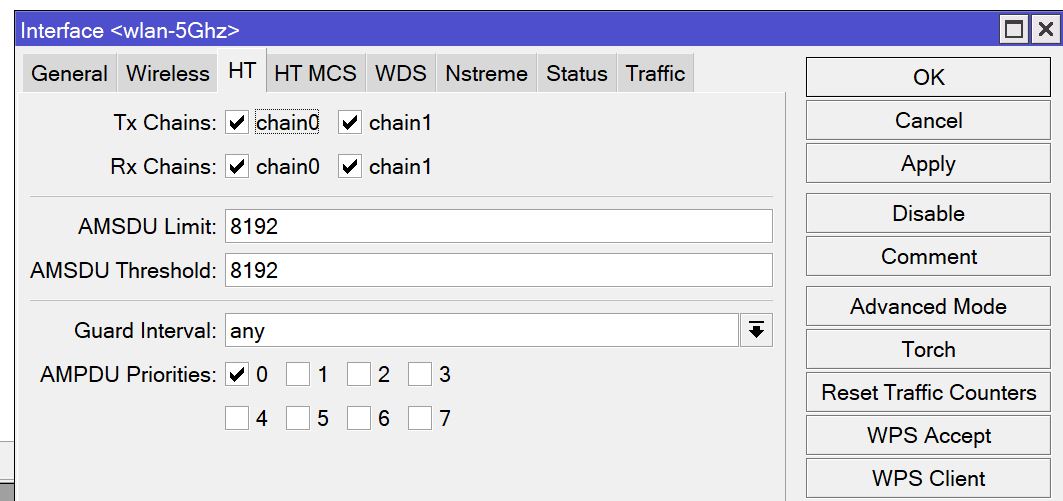

you have somehow downgraded your wifi settings to use only 1 chain and only a 20MHz channel. Did you change the wireless settings yourself? Try to use QuickSet and change it to HomeAP-Dual, then default settings should get applied
Thank you!
Yes, I did remove the default configuration and followed a tutorial online - clearly not the best one I guess!

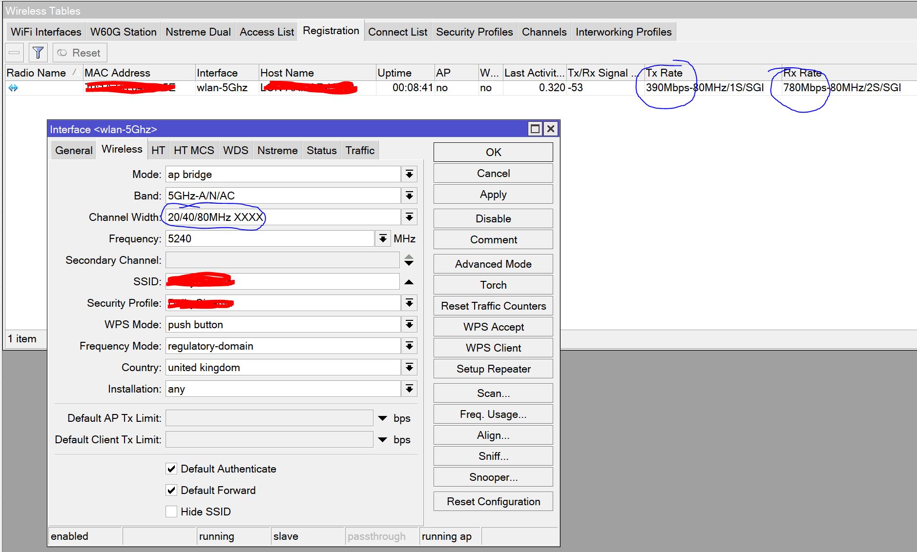

The quickset fixed the chain but I manually changed the Channel Width to “20/40/80Mhz XXXX” - is that the correct setting?
I now see 860Mbit/s bandwidth, which is great! However I am still a bit on the slow side on Windows. I read 250Mbit from my NAS compared to the 300-450Mbit of the other router.

Hello Normis,
After many hours spent on the router, I am not sure I have made any progress :slight_smile:
I’ve reset the router but this time keeping the default setup. Then I changed what I needed - it took me a while to make it work (and still doesn’t, see below).

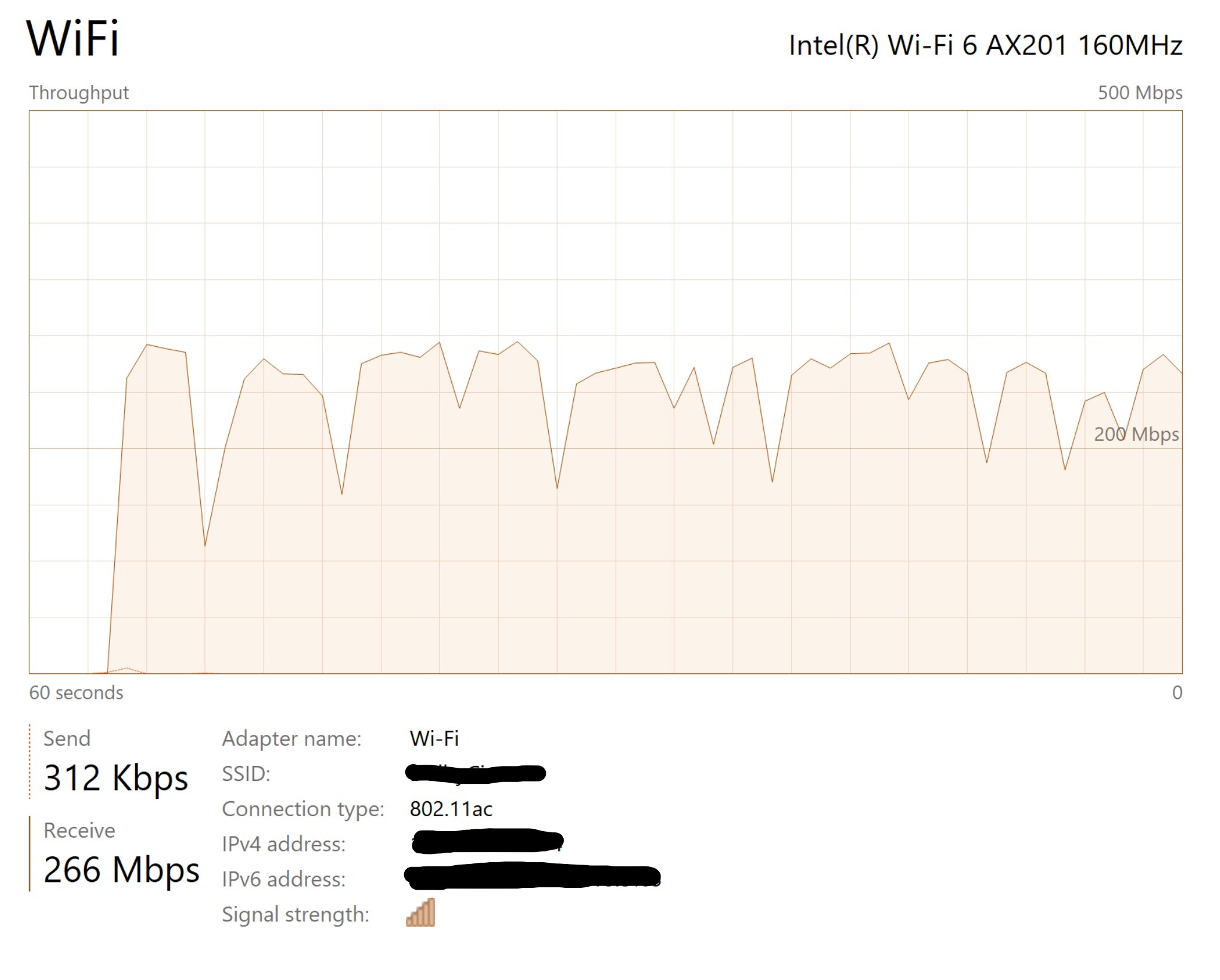

The throughput is unchanged. Please see below, screenshot using my home router and screenshot using the Mikrotik. As you can see there is about 100Mbit/s missing.

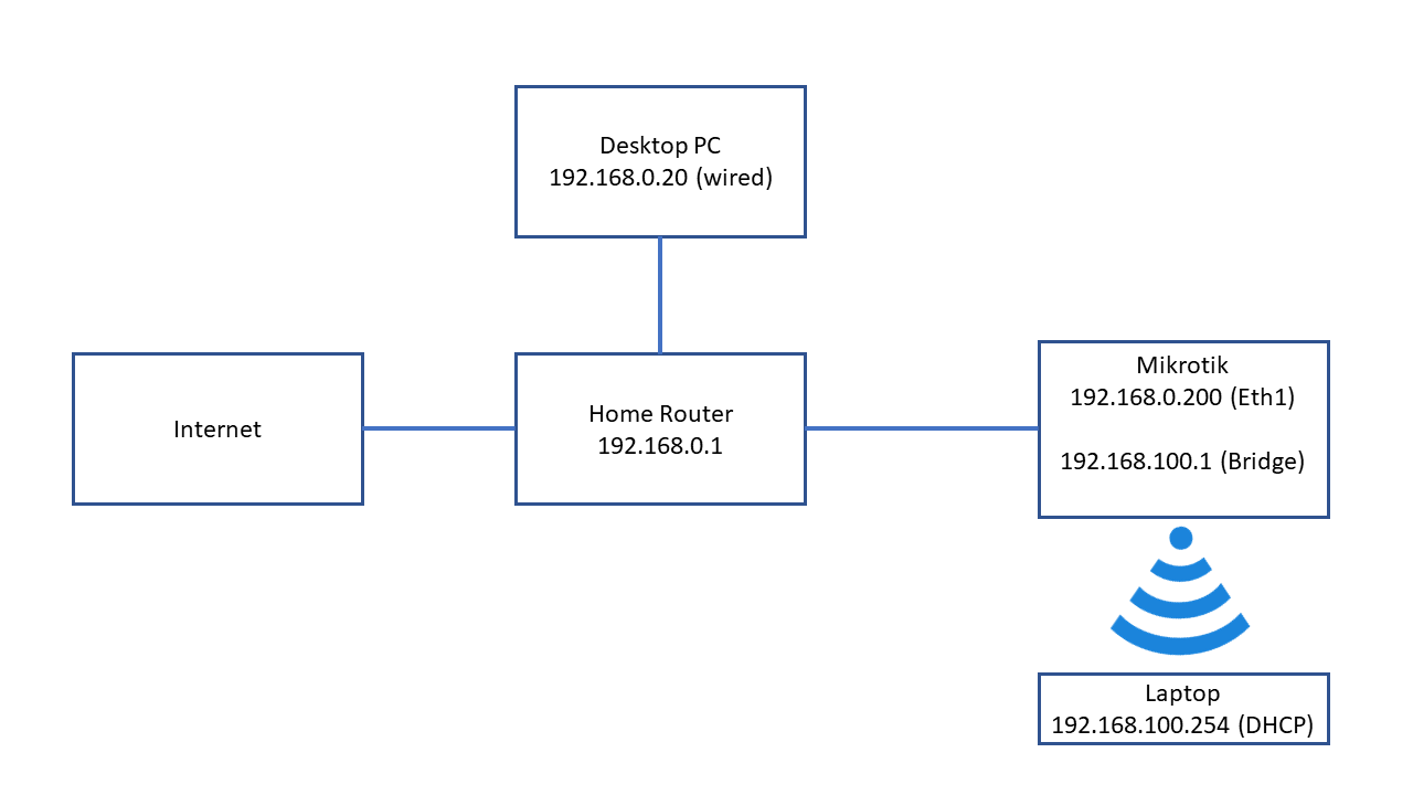

On top of that, Please see a diagram of my network. This is just a test but eventually it will need to be installed in a similar fashion (where I do not have control of the main switch/router and I need to create a separate WiFi on a different network with DHCP server on it).
The problem I have now is that I cannot connect to the Mikrotik from a Desktop PC sitting on the 192.168.0.0 network. Not even via Mac Address. However, I can ping 192.168.0.200! I suppose maybe some Firewall as Eth1 is the “internet” socket?

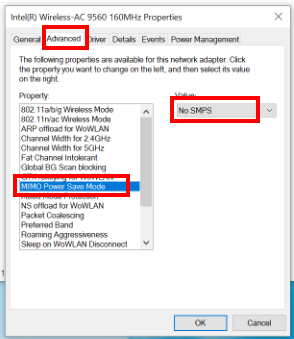

Can you try disable MIMO powersave(set it to NO SMPS) under wifi card extra settings inside device manager and see if it makes speed difference.
Another note on wireless performance: the interface rate (e.g. 833Mbps) is what it says - interface rate. Frames passing interface have overhead (frame headers etc.), then there are inter-frame gaps, duplex gap, etc. So the rule of thumb says that payload rate of around half of interface rate is pretty good result in real life.
Default setup makes ether1 interface WAN interface. Which means that device routes between ether1 and the rest, performing NAT on the way. Also traffic originating on ether1 is subject to rigorous firewall rules (which includes blocking management access).
Sadly there’s no QuickSet mode for a switch/AP configuration of device, that has to be done manually (but it is probably the easiest mode to do manually).
ivicask: no change unfortunately
mkx: that is it! Clearly the Mikrotik is treating my LAN traffic as Internet traffic so it’s applying its firewall to it. The FritzBox isn’t as it’s just relying LAN traffic to the WiFi. So as a test I changed the Mikrotik config to have my laptop on the same LAN network and ignore ETH1. Now speeds are matching the FritzBox if not a bit better.
Amazing. Thank you guys!
Regarding my inability to access the router via the 192.168.0.0 network, I suppose it’s because from the router’s standpoint I am trying to access it from the Internet - and that might be disabled. Can someone point me to how to change that please?
Edit: gotcha. /ip firewall filter add action=accept chain=input disabled=no dst-port=8291 protocol=tcp
Obviously this needs to be carefully thought. But I might want to select a range of IPs from which the management is allowed.

If you are not getting the 866Mbps on 80MHz/2S/SGI then the wifi signal might be disturbed (adjacent channel interference is one of the reasons). Adjacent channel interference happens when the channel you use.overlaps with another channel use that interferes.
When using “5240 XXX”, you have to check what you actually get. It might not be the standard alignment for wide channels as one expects.
See test : http://forum.mikrotik.com/t/v6-49-4-stable-is-released/156240/1
versus table: http://forum.mikrotik.com/t/v6-49-4-stable-is-released/156240/1
“5240 eeeC” would be in line with the table. But the signal around is the only thing that really matters, to have that interference or not.
Any interference, noise or distortion will give faulty transmissions and make the wifi driver lower the interface rate or even the number of transmit channels. (See the 1S in the screenshot) to compensate.

PS: You may want to add interface ether1 to the bridge, to make it all one LAN environment. (Be aware of multiple DHCP servers in that LAN! So one step could be to move the DHCP client from ETH1 to the bridge and remove or disable the DHCP server on the bridge.)
Thank you. I am getting 866. I was getting it before but speeds were not there - it went ok when I started doing tests on LAN and not WAN.
I will have to keep ETH1 on Wan, see my network diagram above. That is a requirement for this project: to have two networks (I thought they had to be VLAN but I see you can do without VLANs on this router), one from where the Internet is coming (and other equipment is reachable) and one for the WiFi on a different network with its own DHCP. These two networks must be able to talk.
