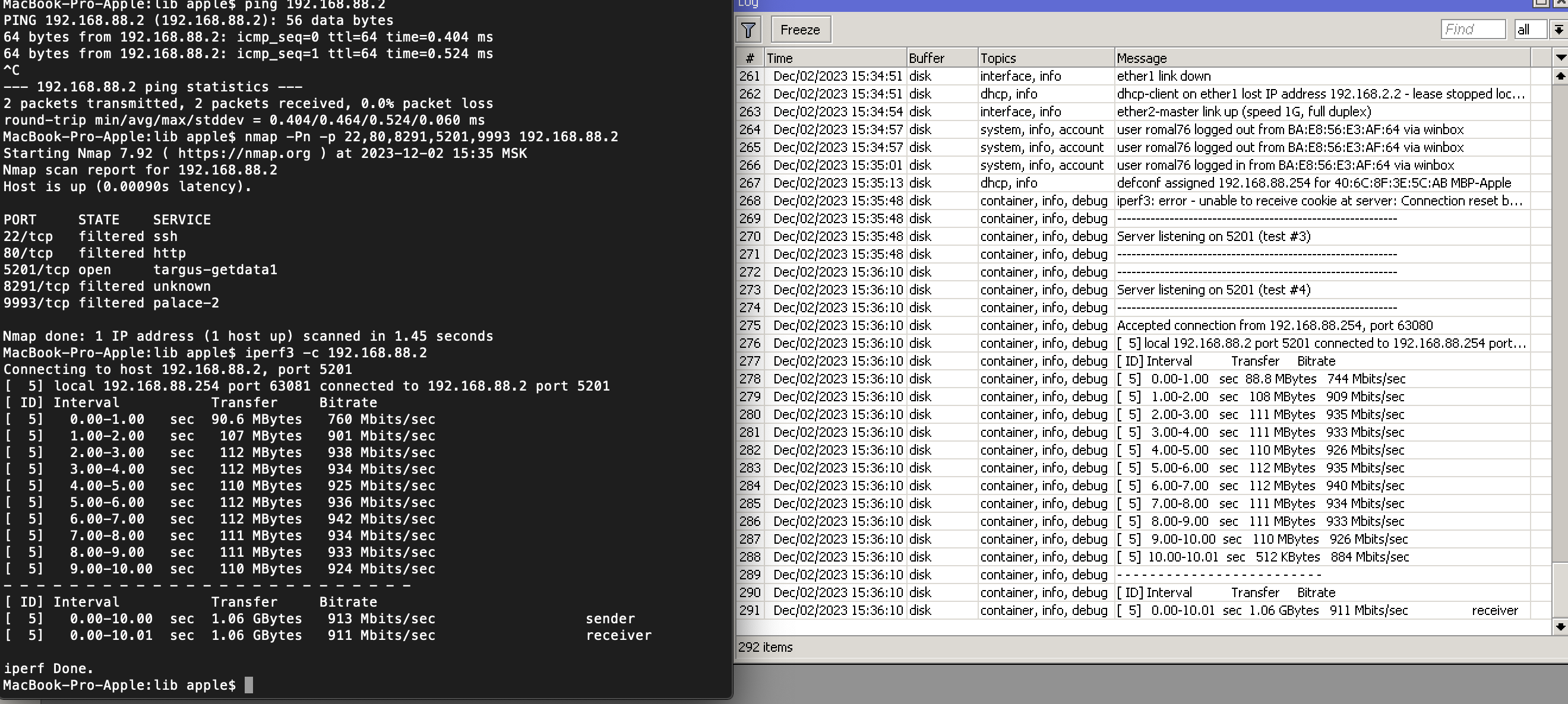

I have only one bridge that contains all ethers and veth1.
veth1 having address 192.168.88.2
PC having address 192.168.88.254
Packets from sniffer is in attachments
But iperf3 still having error
Allowing everything else from every other source, including the WAN is temporary for testing purposes only

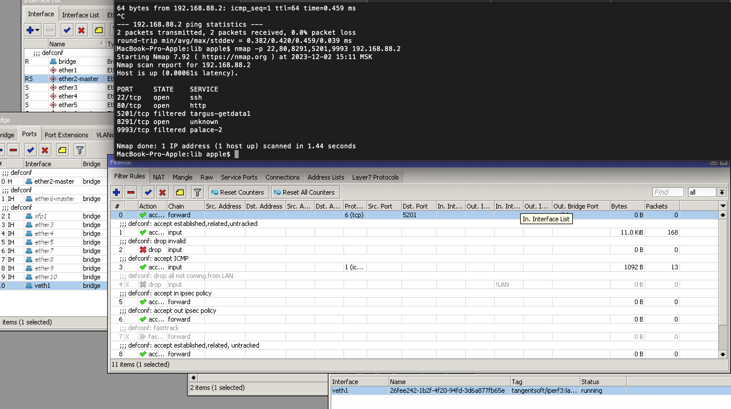

Try adding this:
add place-before=0 protocol=tcp dst-port=5201 \
    action=accept chain=forward out-bridge-port=veth1
done, nothing has changed
I don’t understand what’s going on, then. My rule specifically allows this connection at the first place in the configuration where it can take effect. The only thing I can think of to broaden it is to remove the “out-bridge-port” bit.
Your claim is that nmap still reports that port 5201/tcp is still filtered after adding this firewall rule?
yes, still filtered and also zero counters on new rule
In that case, I would delete that empty “containers” bridge, delete the container, and recreate it using the command given at the top of my docs on this container.
am I need to use “bridge1” or already existing “bridge” ?

it’s working now, thanks

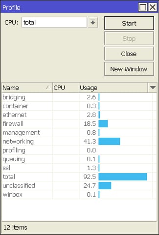

Here’s a screenshot of the RouterOS profile I get while doing a ~4.1 Gbit/sec test over OM4 to an RB4011 with iperf3 3.16 set for 4 parallel threads:
That’s a pretty direct scaling factor: four times the bandwidth for four times the CPU power.

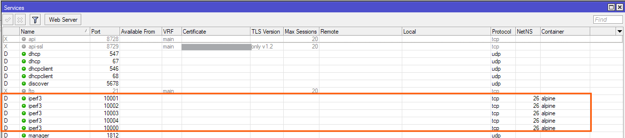

You can add an Alpine container (remote-image=library/alpine:latest cmd="sleep infinity" start-on-boot=no), then start the container in the shell:
/container run alpine cmd="ash"
In the shell, add the iperf3 package with:
apk add --no-cache iperf3
You can then create a simple shell script that starts a few instances of iperf3:
#!/bin/sh
/usr/bin/iperf3 -D -s -p 10000
/usr/bin/iperf3 -D -s -p 10001
/usr/bin/iperf3 -D -s -p 10002
/usr/bin/iperf3 -D -s -p 10003
/usr/bin/iperf3 -D -s -p 10004
/bin/sleep infinity
Don't forget to set the executable flag (chmod 755 ...). Exit the Alpine shell. Once that's done, you can start your iperf3 instances anytime from RouterOS with:
/container run alpine cmd="/path/to/script.sh"
You can verify that the iperf3 instances are listening in IP -> Services:
Once tests are done, press Ctrl+C to stop the container.
If you want the iperf3 instances to run all the time, edit the container to set cmd="/path/to/script.sh" and turn on start-on-boot=yes.
