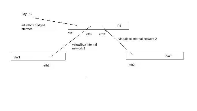

Im creating small environment in oracle virtualbox, which contains one router with two switches connected.
Whole setup is basic and started from scratch and have no more options than default:
R1 - created new bridge, added ports ether2 & ether3. Bridge1 adressed with 192.168.88.1/24. Ether1 is bridged with physical card, (basically to get access into R1 RouterOS from winbox).
SW1 - created new bridge, added ports ether2 & ether3. Bridge1 adressed with 192.168.88.2/24. Connected by ether2 with R1_ether2 with virtualbox internal network 1.
SW2 - created new bridge, added ports ether2 & ether3. Bridge1 adressed with 192.168.88.3/24. Connected by ether2 with R1_ether3 with virtualbox internal network 2.
Got some problem with ping between devices in this setup. It works only, when SW1_ether2 and SW2_ether2 are removed from bridge, ip address are set on ether2 (both switches), and only, when both ports are connected to the same virtualbox internal network (1 or 2) at the same time.
Each VMs with CHR is created from scratch with unique NICs mac addresses.
Perhaps there is something i didn’ get yet, please help.

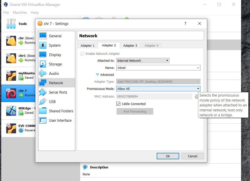

‘Promiscuous Mode: Allow All’ is the key of solution.
Set ‘Promiscuous Mode: Allow All’ in VirtualBox, on the appropriate machine and adapters. After this, operation will be as expected.
VirtualBox:
Select machine, Settings, Adapter(on all bridged adapter), Advanced, Promiscuous Mode: Allow All
Picture, for example, in my case:
