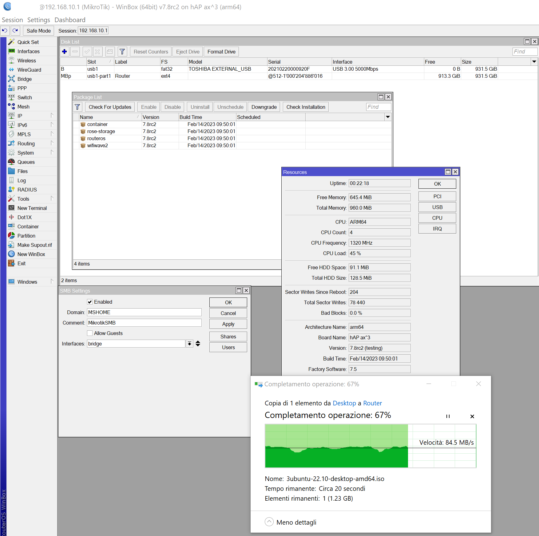

hAP ax3 with usb3 mechanical hdd (FS ext4) and this is the smb write speed with Windows:

For me it’s fast 100 MB/s read and 70/80 MB/s write, I formatted the hdd in ext4.
