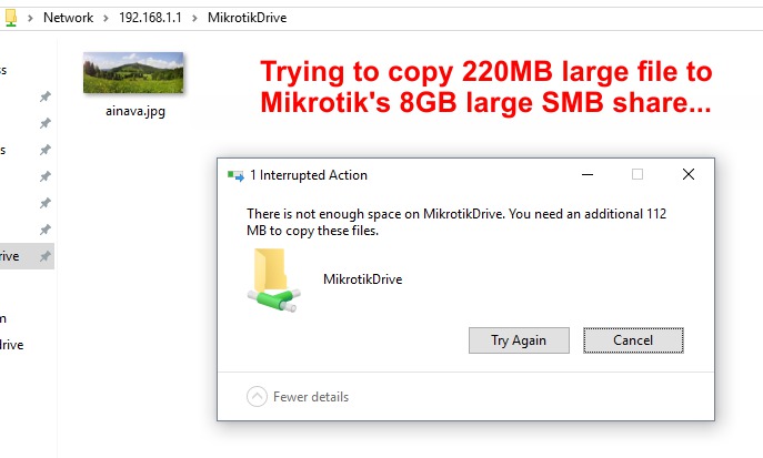

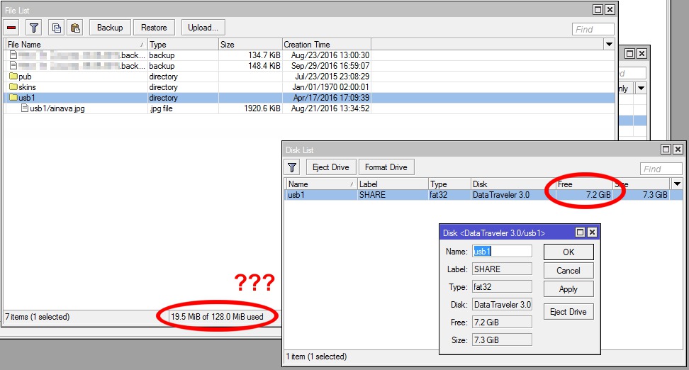

Long story short - some time ago I connected 8GB USB flash drive to my Mikrotik RB2011UiAS router, and made an SMB share out of it - just to use as simple and convenient NAS-like place in home network to exchange small files between devices. It has worked perfect up till now, but today I needed to copy a bit larger file to this SMB, and it turns out that Mikrotik only allows 128MB of 8GB shared USB to be used..?
Please see attached screenshots to better understand my complaint -

As 128MB is actually the storage size of this router’s built-in memory, could there be some issue related to router mistakenly thinks that I’m trying to copy file to internal memory, instead of external USB drive?
The first window shows the router NAND size, not the disk size, so all is OK.
It seems you configured SMB on the built in NAND chip, not on the disk. Show us the SMB config

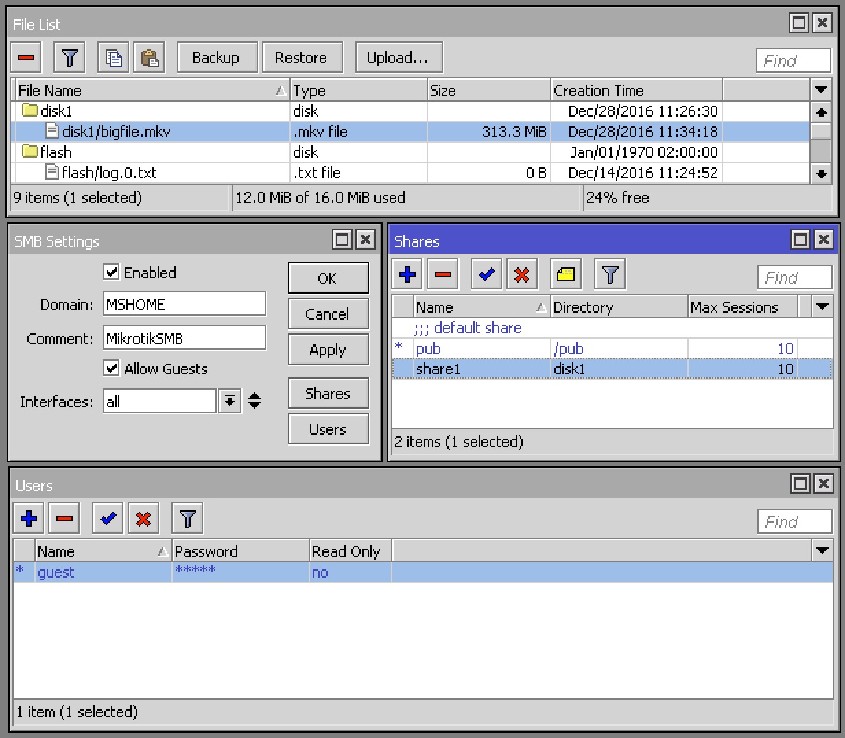

Here is my config with correct share directory added as disk1:

Hi, Normi!
Thank you for your answer - you were right, I indeed accidentaly had configured router’s internal NAND memory as my shared drive. I guess the fact that internal memory is called /usb1 confused me. I just changed the shared drive to /disk1 and everything works fine now. Well, the only thing that kind of bothers me a bit - while on internal memory file transfers started as soon as I drag the file over to network drive icon, now when I set the USB flash as shared drive, there is slight delay before the transfer starts (like some 6-10 seconds just frozen on “preparing for copy” dialog, before actual transfer begins). But the transfer speed rose from 2MB/sec to 6MB/sec, which is nice.

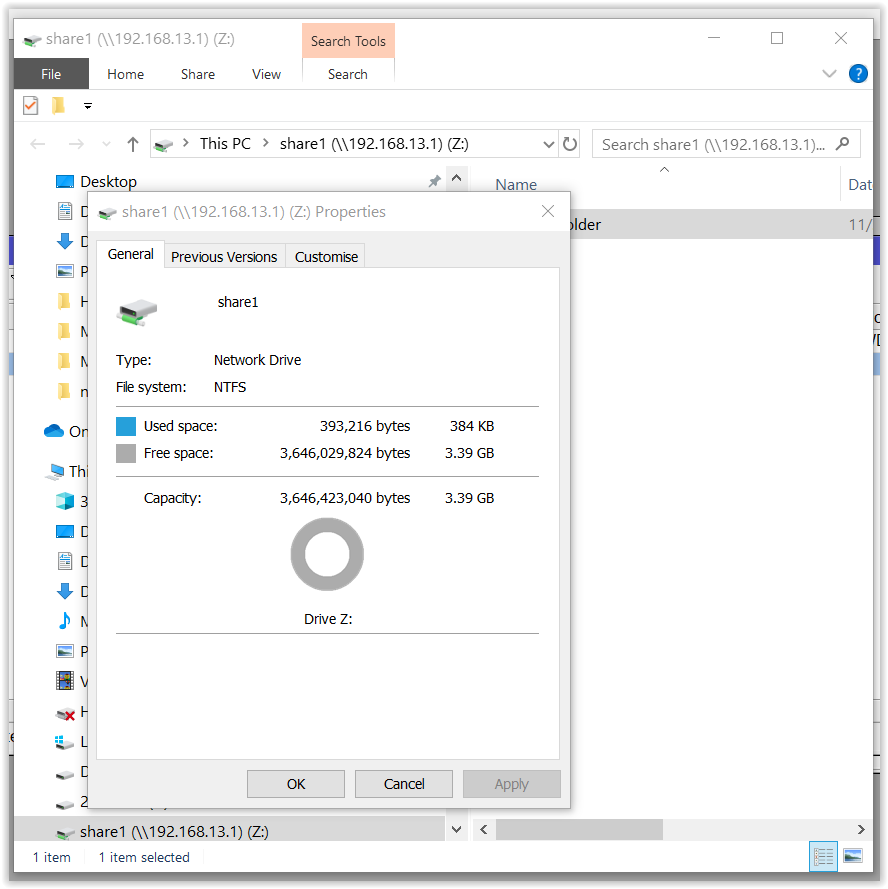

I haven’t succeeded with my new RB5009. No matter what size USB drive (16GB, 64GB, 500GB, 1TB) I have tried share on the Windows network via SMB, the drive size gets under-reported in both Windows and Linux and I can’t copy files to it larger than that which the operating system reports. Below is my configuration for a 64GB Mushkin USB 3.0 flash drive. Notice how only 2.37 GB is usable:

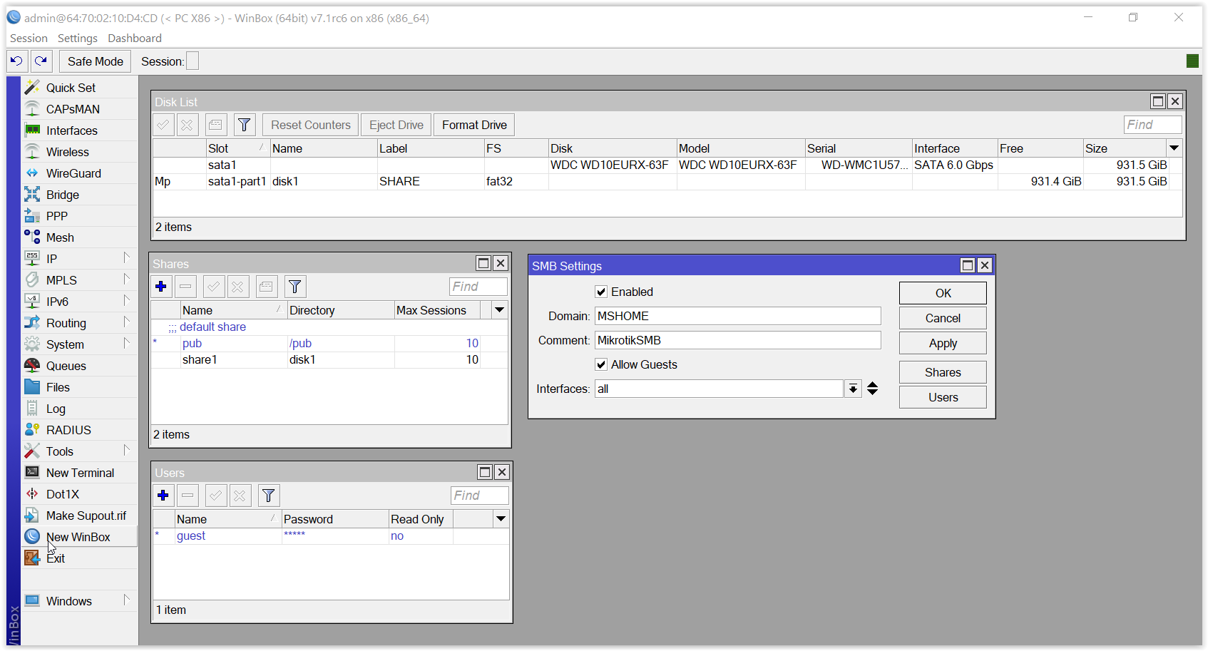

I haven’t succeeded with my new x86 machine. I have 1 TB HDD but in windows explorer it’s only detected 3.39 GB. I can’t copy files to it larger than 3.39Gb, Below is my configuration for a 1TB HDD connected by SATA cable,
Does any body could give me suggestion ?. Thank you.
I tried copying a 3.9GB file from Linux Mint v20.2 to MikroTik’s RB5009 shared USB drive, and like Windows 10, I got the same warning that insufficient drive space was available even though the 500GB USB drive had nothing on it. But unlike Windows 10, Linux gave me the option of copying the file anyway and I was able to do so with no problem:
Then I found this webpage which seemed to explain why this happens:
https://superuser.com/questions/1423396/samba-reports-incorrect-disk-space-when-on-shared-mount-points-not-directly-bene
I sure wish MikroTik would correct this. I bought the RB5009 with the hope that the USB 3.0 port wouldn’t have this problem but it evidently persists on many of their products.
