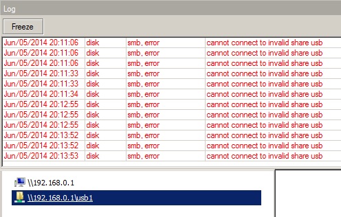

SMB also needs to get fixed. There are some problems with it. My shares appear and dissappear without any reason. Also Windows says “folder name is invalid” for share that I accessed some time ago without a problem. RouterOS cuts one letter at the end of share name. I try to access share usb1 and it says that usb (without “1” at end) is invalid. Look at the screen below:
I share folder: /usb1 as usb1:
[admin@dupa] /ip smb shares> export
# jun/05/2014 20:23:17 by RouterOS 6.13
/ip smb shares
add directory=/ name=root
add directory=/usb1 name=usb1

Not in my case. USB is mounted in /usb1, so this seams fine.

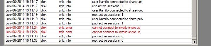

Today I changed share name to usb (now it is: share usb set to directory /usb1) and now I CAN open share \192.168.0.1\usb, but when I was mapping this share to drive letter I got this error (again with one letter cut at the end):

After changing share name I can map drive AND connect directly. At the moment it works fine. I will wait until it stops working again and post here.
Again, after reboot my share usb (set to /usb1) was inaccessible. I changed it’s name and now it works fine. So, this seams to happen after reboot. Tested on two RB2011UAS-2HnD.
For workaround, make one script than change name and revert back…
Good idea.
Thanks! :smiley:
