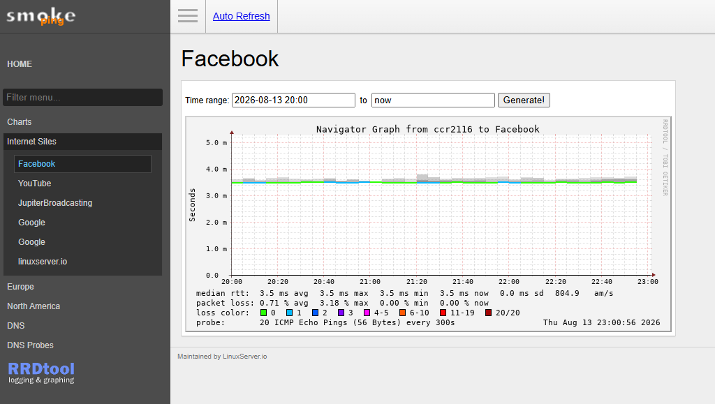

When generating a graph for a custom timeframe, the form action links to "http://localhost/ .." instead of the actual host and port combination that's being used. Is there a setting to correct this or a way to get it to use a relative path instead?

Just by clicking on any of the graphs until you get the option for a custom timeframe. For instance:
If I click on the "Generate!" button in the screenshot, it'll go the the above mentioned localhost url.

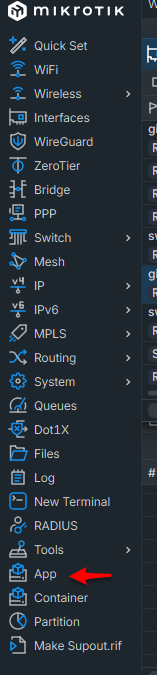

This app feature, in Winbox, which is also present in the text config under /app/config.
