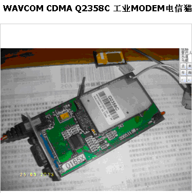

And now I’m planing to buy a cdma moden with COM port(see my uploaded pic), but I’m not real sure it will work or not.May be someone can recommend me one?

It didn’t work because “AT+CMGF=0” is not supported by the modem,“0” means use PDU mode to send or recevie message . I think I should find another modem
