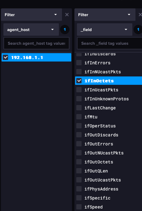

I don’t see the filed for interface instant transfer values trough the SNMP
Please could you help me to understand ?
I see only this in influx database linked to Telegraf source :
Yes, those are all increasing counters. You need to use something like Grafana to take a non-negative derivative to get the rate.
which is the field to use ?
"ifOutOctets " ?
Could you help me to create the Grafana query ?
If you are using Influxdb version 1.x the classic query for interface traffic is:
SELECT non_negative_derivative(mean("ifHCInOctets"), 1s) *8 AS "Input", non_negative_derivative(mean("ifHCOutOctets"), 1s) *8 AS "Output" FROM "autogen"."interface" WHERE ("hostname" = 'MikroTik') AND $timeFilter GROUP BY time($__interval), "ifDescr" fill(null)
