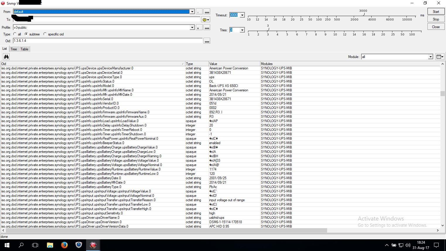

SNMP OID Float values
OID’s of Float Syntax do not appear correctly in The Dude (v6.40.2)
snmpwalk of the same OID’s show correct values
(see OID’s upsInfoLoadValue, upsBatteryVoltageValue for example)
Is this a new feature request or a bug?
