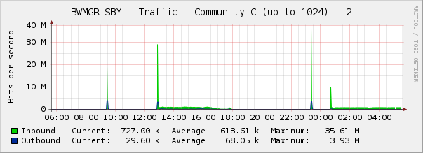

I have a problem with cacti graph from queue simple. Sometimes the graph didn’t show anything (0). When I tried query again in cacti device, the graph show normal (after graph show spike until 20-50mbps, although the real traffic just 500kbps). But after couple hours, back show nothing…
I need upgrade to version 5.x because I need to limit IPv6 with queue simple. Thanks.
The problem has a solution? I did upgrade to 5.4 today and I still have incomplete data collections of simple queues. What it is necessary to provide support?
Did you wrote to MikroTik support team? :slight_smile: Send them the description of your problem and attach the supout.rif file made just before you sent the email
