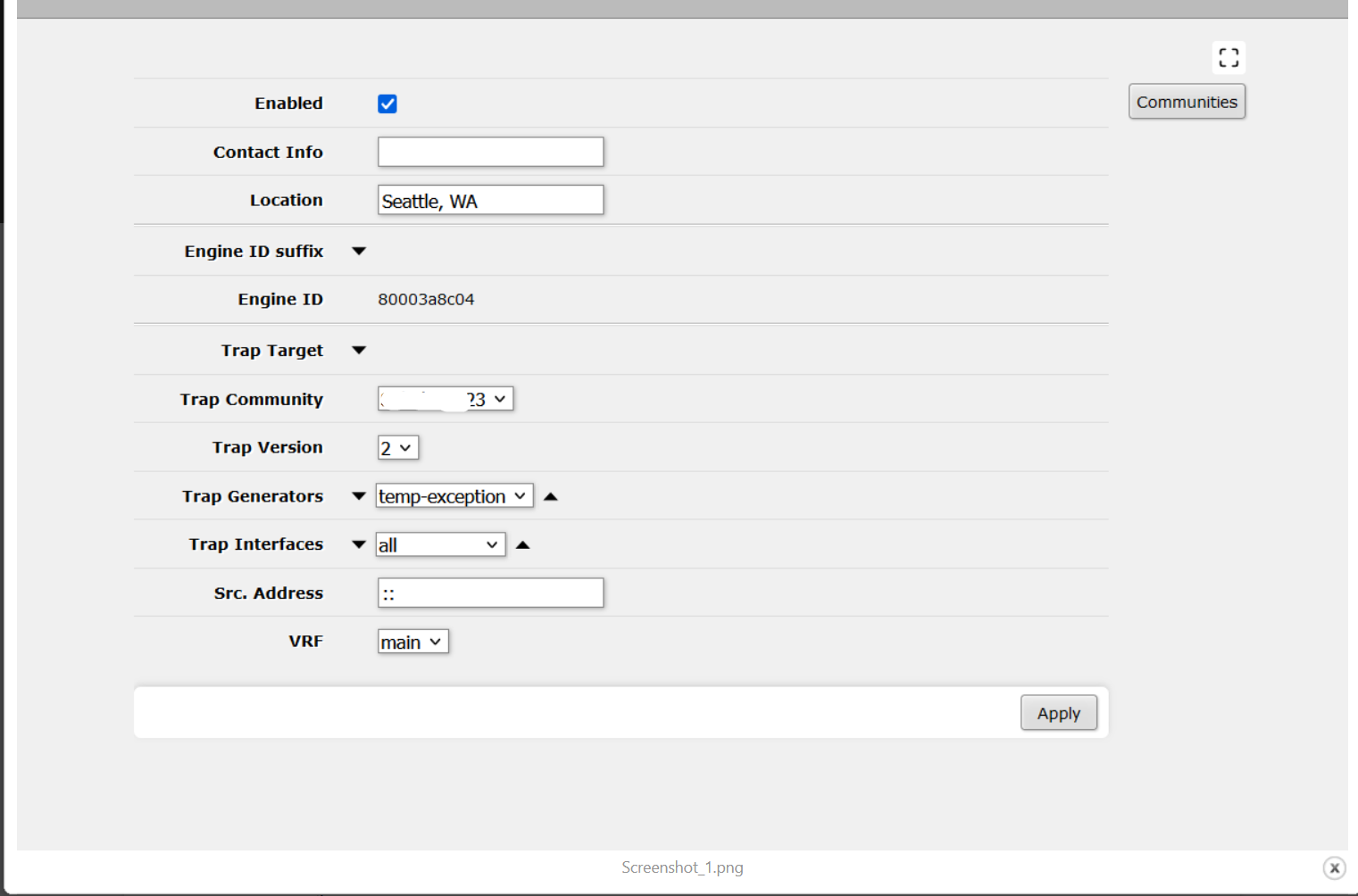

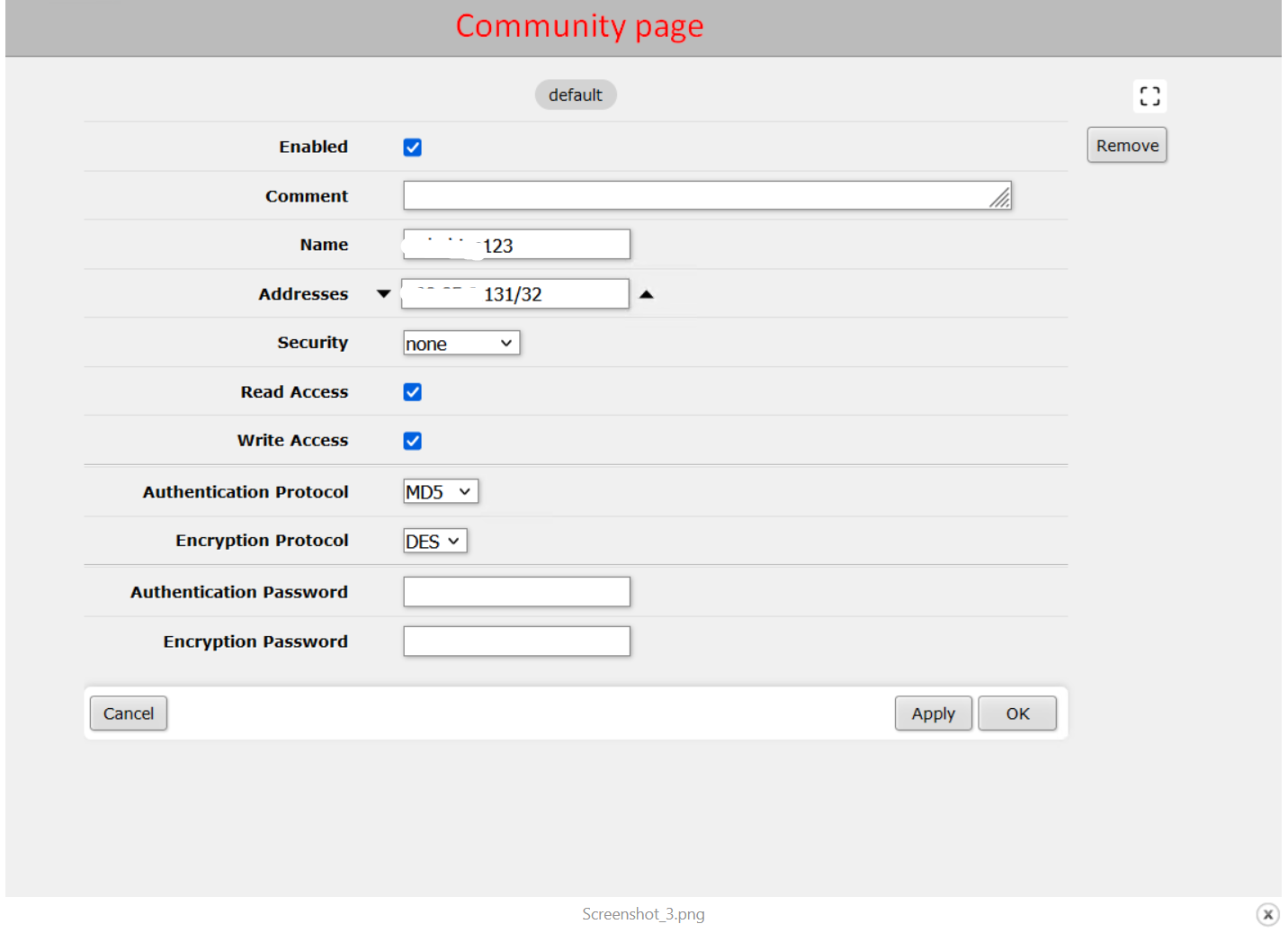

We have an issue with our CRS354 switch in which it is not sending SNMP data correctly. It is sending the wrong Integer (port number) for interfaces (see attached)

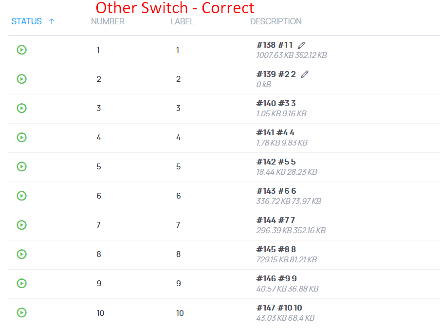

This is causing our EasyDCIm to get the wrong port number for these interfaces as seen in the attached image. On our other switches the integer number matches the interface or STRING number.
