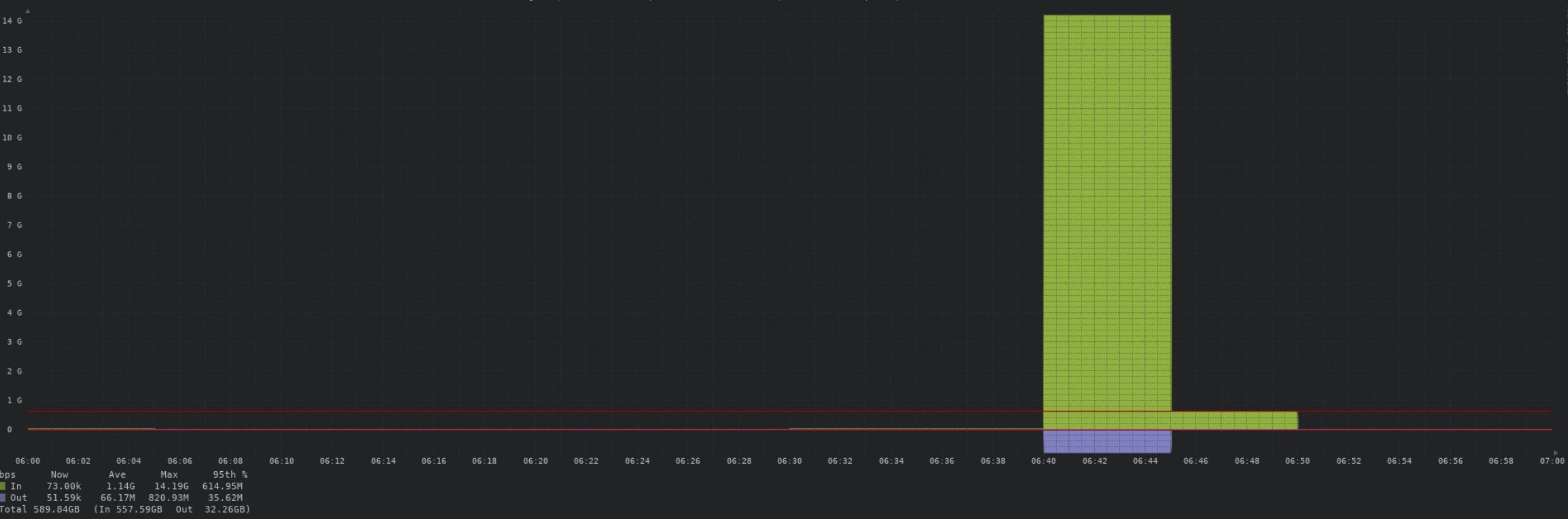

In (i-)regular intervals the values read via SNMP are just bogus. This two screenshots show what i mean:
This is on a gigabit link, later shrinking to 100megs… 14.19gigs down… I’d wish xD
so something clearly isn’t right with the SNMP reading.
funny enough, having a lot of devices running 7.11.2, i only get this on my CCR2004-16G-2S+ ¯_(ツ)_/¯
