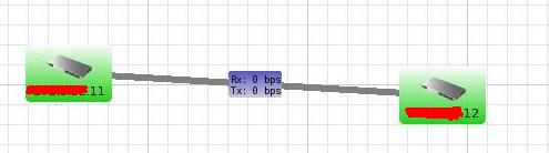

Since my Wed Jan 11, 2012 1:03 pm post, I have elements that show you the the bad dude map link label in SNMPv3.

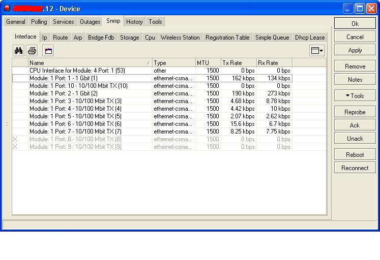

  1. the response speed on the port 1 of the switch 12 is good. See the image attachment.

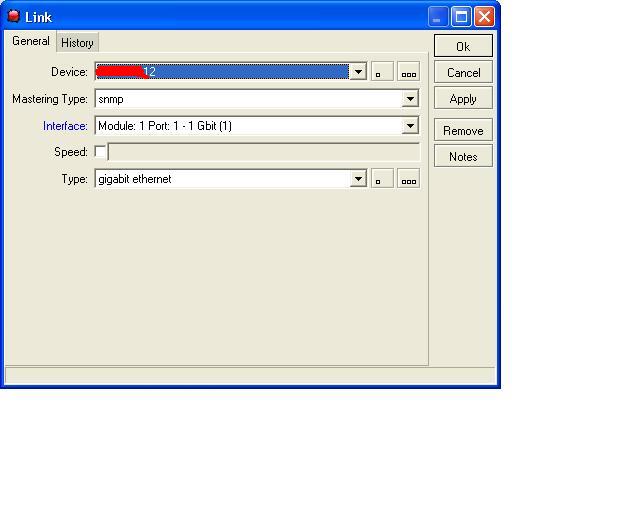

  2. the link features on the port 1 of the switch 12
  3. and the map is not good, we have Rx: 0 bps/Tx 0 bps or later Rx: [Interface.InBitRate] Tx: [Interface.OutBitRate] but never the good value
