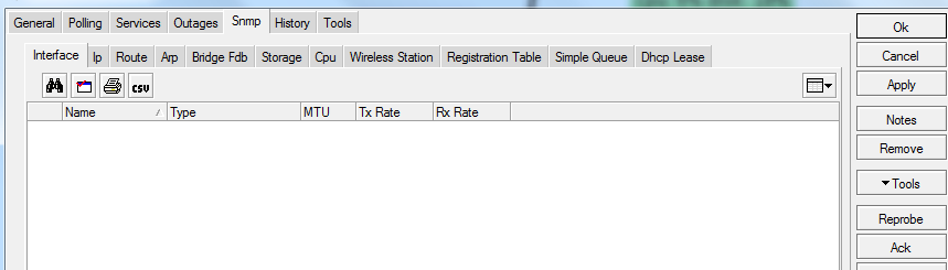

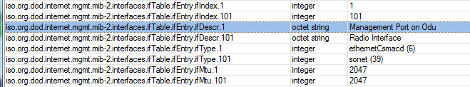

My issue is with a map link. I select mastering type of “SNMP” but the interface does not show up. If I walk the device, I see the interfaces. See the attached.
Suggestions?

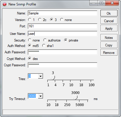

Yes, I saw interface data but was very slowly updated - approximatelly 5-10x per minute. Using “winbox type communication” was much more faster (1-2x per second). Unfortunatelly I fully uninstalled Dude so I cannot show you how it worked. But the setting was quite intuititve, I did not need to consult any manual for SNMPv3 settings. - You need to create special profile for this in Dude and switch it within all devices or make your profile to be default for used types of devices, as I remember. I used both authentication and encryption. Also the special community has to be set and enabled in each device.
Hmm. I have done that. I can walk the device (as depicted in first post), but the interfaces to do not show up (see additional image).

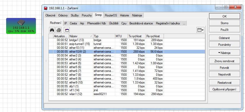

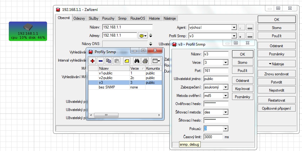

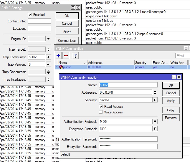

Hi, so I did it and it works (tested with dude 3.6 running on Windows):
Check the pictures, you have probably something wrongly set.
