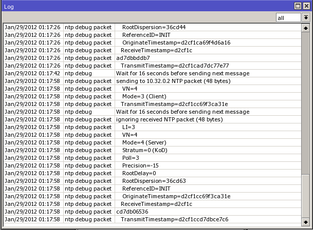

Odd - I’m getting the same! (RB493G v5.5) Except mine is trying to talk to another MT, an RB1100 on v5.5 E.g.
your log says “ignoring received NTP Packet”, but i don’t receive any packet at all

In my case, I pretty much think this is a bug, as the error message is that the client is getting a message from the server that the time is not synchronised, when it is!
For you, if you’re using a Microsoft server, there are some tweaks you have to make in the Registry. Search the forums, there are references on what to change.
