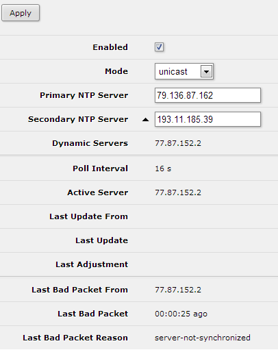

I have a problem with synchronizing time.
I have configured timezone in Clock configuration tab.
And configured SNTP client. I put Primary and Secondary NTP Servers.
But I it doesn’t synchronize.
It displays me the next:
Active Server 77.87.152.2
Last Bad Packet From 77.87.152.2
Last Bad Packet Reason server-not-synchronized
77.87.152.2 it’s not a either Primary or Secondary NTP Server, it’s some IP of my Internet Provider.
I have not changed anything except this Since I bougth 951g-2hnd.
Please help.
Thanks.

Look at attached files please.
77.87.152.2 - it’s a DNS Server of my Provider.
Thanks.

I noticed that Last Bad Packet From 77.87.152.2 which is DNS of my Provider.
But I think there should be at least IP of NTP Server.
Maybe something wrong with my DNS configuration or Firewall or something else.
But internet works fine.

I have resolved my problem.
I set Address Acquisition to static and put all config include DNS servers by hands and it works perfect.
Thanks.
