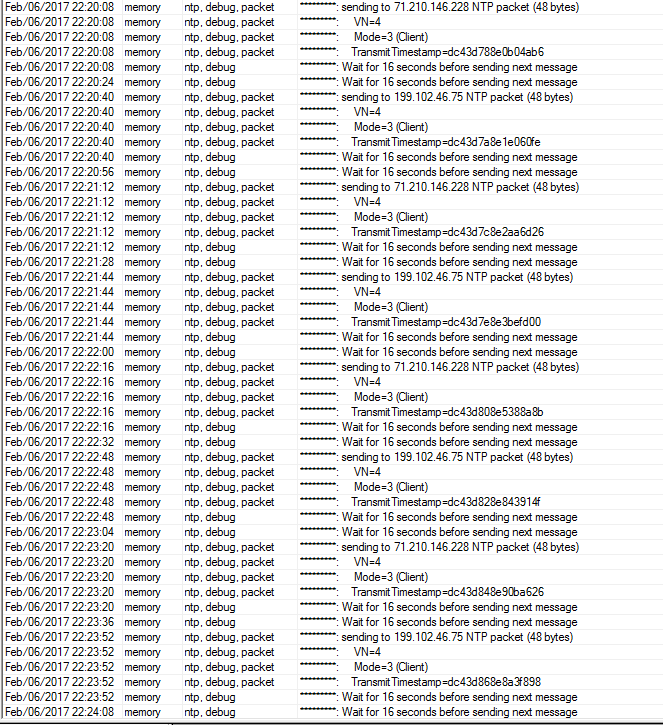

I have 20+ Mikrotik routers in the field at client locations. These are mostly RB750s, but there are also some CCRs. At some point in 2016 the SNTP stop adjusting the clocks on all of these routers. I’ve tried firmwares from 6.12 to 6.38, with the same results. I see the NTP request go out, but nothing is coming back. None of these router are behind firewalls; they are all connect either to fiber ONTs or bridged modems directly from the ISP.
I do have one CCR1016 behind a SonicWall that is working. It’s the only one I have that the SNTP is working.
Looking for ideas where to look? Or what to try?

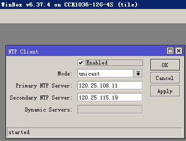

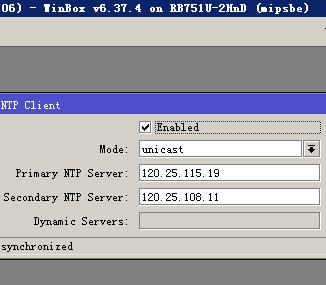

i have same problem 6.37.4
Then talk to your ISP as well!
rb751u is ok
