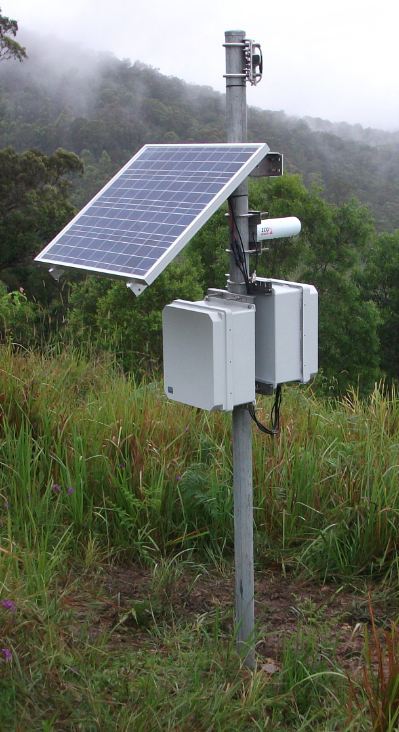

My solar relay with 3G modem + 711UA-2HnD
i can’t believe that this works 24x7 !!
