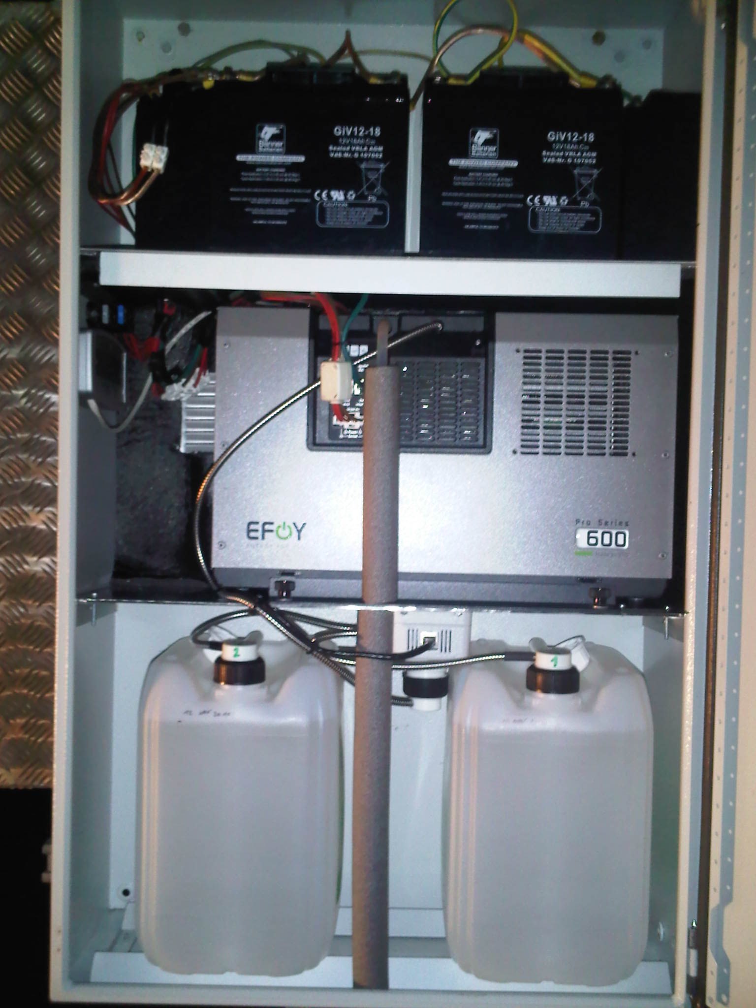

we updated one of our solar stations with SFC fuell cell “EFOY Pro 600” 2 weeks ago because we had troubles during winter, and now we hope, and it looks great, that we dont need to climb the hill with one of our small honda generators agin…
we have 2x 120W solarpanel, and now we have only 24V 72 AH capacity because we needed the space for the fuel cell and the metanol tanks
before we had 24V 220AH and often had problems during winter - we only serve 1 RB430AH with 3 Wirelss cards and during daylight we have 2 mobotix cams running and a weatherstation - this maks a maximum power usage of 0,6A at 25V during dayligt and about 0.37A during night
at http://www.soaringclub-hohewand.at you can find the cams (see the solarpanels) and the weather
http://www.sfc.com/

Out of interest how much did the methanol Fuel cell system cost you?
There isn’t any prices or dealers in australia, So just ballpark.
around 4000€ including the 2-tank switch - that automatically changes to the other tank when the first one is empty
and can be monitored also via serial console like this..
should be cheaper allready - there is a new consumer line from efoy avaliable
SFC>sfc
battery voltage 28.02V
output current 0.00A
operation time (charge mode) 1039.2h
operating state: auto off
operating mode: auto
cumulative output energy 20563.8Wh
no error
cartridge level above sensor or no sensor (cartridge 1 consumed 2.09l)
