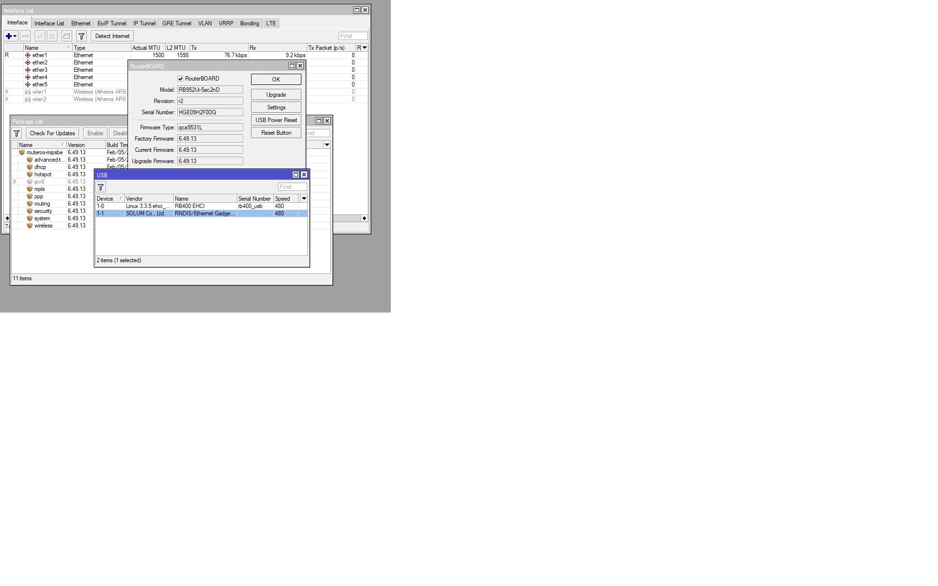

I have a Mikrotik hAP ac Lite and was hoping to use the USB port to run a Solum USB adapter. The adapter shows up as a RNDIS device as you can see from the screenshots attached.
How do I get that to be a routable interface - or give it access to the internet?

While ROS is based on linux kernel, it0s pretty trimmed down to fit tight storage and RAM. So typucally it ships with very few device drivers. And knowing name of device doesn’t have anything with driver availability.
Having written that: it’s highly likely that your gadget is not supported in ROS. You should contact mikrotik support directly at support@mikrotik.com to get definitive answer.
