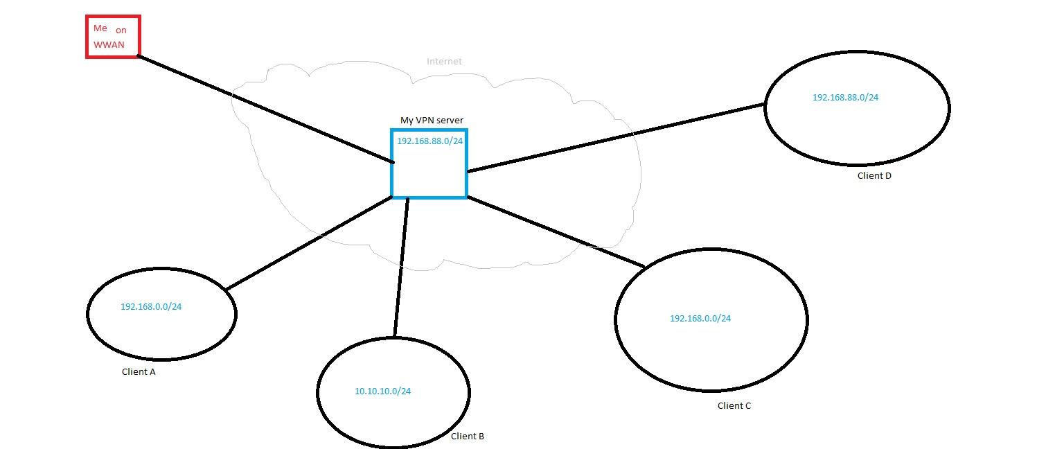

I’m stuck at how to configure the routes for the VPN client>server so I can access the client’s subnet because these subnets overlap, for example I have multiple clients that use 192.168.0.0/24. I know NAT can be used but I have not reached.
I was thinking of using SSTP on the Mikrotiks to call home to my VPN server over port 443. I would then connect to the VPN server myself and access the client’s LAN and\or Mikrotik router. But how would I resolve the issue with overlapping subnets?
For the client devices to connect just masquerade will do.
However the problem here is to select access those devices from the VPN server or from the “ME on WWAN” point.
Different IP addresses will be needed to identify/separate the different clients, in a VPN server managed consistent IP network (with unique IP addresses and subnets). The translation to the local (and non-unique) IP addresses is then done before accessing them. e.g. The Client A and Client C subnet is mapped in a different subnet of the global consistent IP network.
Devices are addressed and connected with their global consistent IP address, that gets DST-NATted and routed to that local IP address.
The route may include the %interface, to make it unique for routing. But more can be done with connection marks and routing marks, routing tables, VRF, … .
