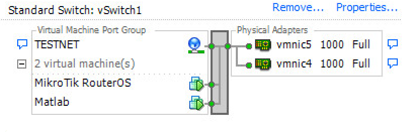

I have 2 RBwAPG-5HacT2HnDs to setup a home wifi, and I’m trying to test these APs with RouterOS in Exsi before wiring them to real RB2011.
but these 2 APs can’t be connected to the RouterOS router at the same time, if only one AP is connected, every thing is good. But once the 2nd AP is connected, usually the 1st one will be “kicked out”, be inaccessible, the 2nd AP is unstable as well.
This issue has nothing to do with CAPSMAN or wireless, the problem is I can’t let 2 non-router RouterOS live in the same subnet.
the topology is
vmnic 4/5 connected to 2 WAPs, MATLAB is where I manipulate winbox, MATLAB is working great, accessible to internet.
the RouterOS router setup is very simple, it plays as a secondary router after a real RB2011 which is functioning, and these 2 WAPs are hooked directly to this ESXI router

I finally figured it out, this issue is caused by esxi’s vswitch.
I will show that’s not working and what’s finally working
NOT WORKING
modem → vmnic0 → vswitch0-> ether0 → RouterOS → bridge → ether1 → vswitch1 → vmnic1 → wap
-> vmnic2 → another wap
even promiscuous mode is accept, it’s not working
WORKING
→ ether2 → vswitch2 → vmnic2 → another wap
and set promiscuous mode as accept in every vswitch on esxi.
if bridge is removed from RouterOS, there will be no such issue nor other weird issues.
the following setup works as well.
modem → vmnic0 → vswitch0-> ether0 → RouterOS → bridge → ether1 → vmnic1 → real switch with rstp and fast port on → wap
-> another wap
-> AP from other brands
but some ap from other brands may fail acquiring IP from DHCP.
anyway, using RouterOS on esxi is totally a nightmare.
