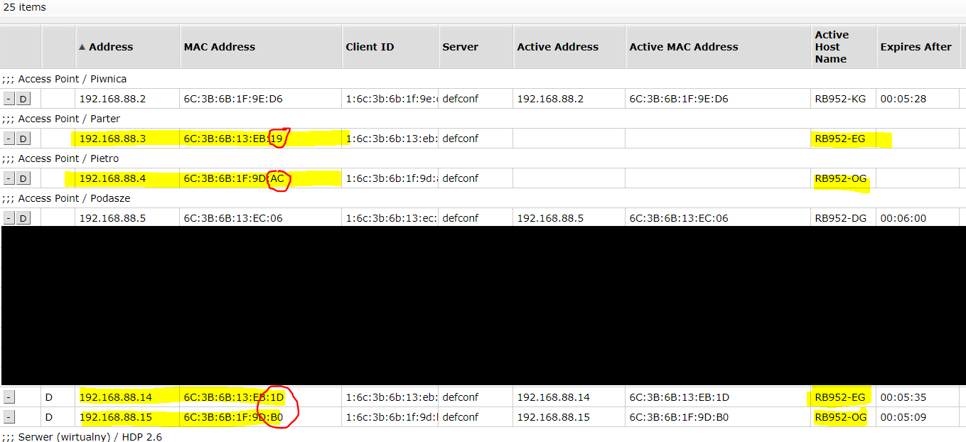

On the RB3011 I have assigned static IPs to all 4 APs (DHCP Leases → make static) however I must’ve done something wrong. Oftentimes on restart different IPs are being assigned. Yesterday I also noticed that the MAC Addresses are different (last hex number differs) although I can’s say if the same was before I made software and FW upgrade. I think that this changing MAC address causes the problem, although I am also convinced that there is a better way to achieve waht I need.

If MAC address was changed on the client then of course DHCP server will give different IP address.
I’m guessing that you have put the dhcp-client on the bridge on the APs.
The DHCP client will use the mac address of the bridge.
If you have not set an admin mac on the bridge then the bridge will pick a mac from the interfaces in the bridge, and that can change.
So the answer is, set an admin mac on the bridge.
Nick

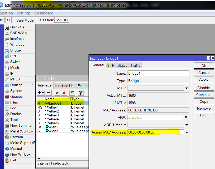

Nick, Thanks a lot for your response. Now would you be so kind and “Explain like I’m 5” this to me? What is an Admin MAC? Are you talking about this one?
:slight_smile:
Yes thats the one, you can see above that it has chosen a mac address of one of the interfaces assigned to the bridge.
If you take the mac address it is currently using, which starts 6C and make it start 6E instead then you will have set a special private admin mac which will be unique and won’t change.
Hope that helps
Nick
Nick, brilliant. Works like a charm now. Thanks a lot, greatly appreciated.
