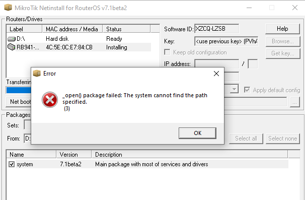

I have the same issue, load 7.1beta2 via netinstall on a hap lite. Netinstall gives an error on the end of the install, but the package seems to be loaded on the device.
I can log in for a few seconds to the device, view the log and then it gives a out of memory error, kernel panic and reboots.
Nothing has been changed to the default config.

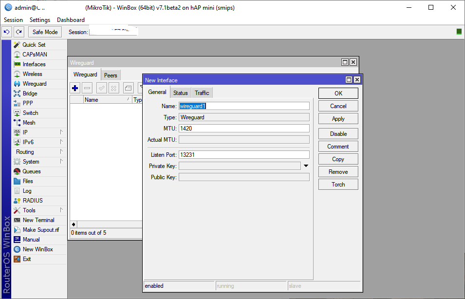

oh, in latest winbox 3.27 there’s the gui for wireguard, too, i think it’s new, i read you had to configure it via console previously…
