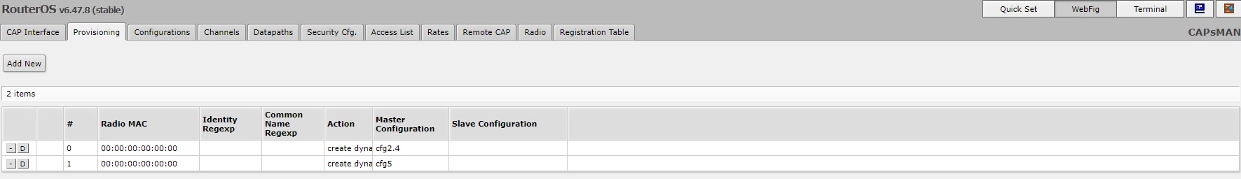

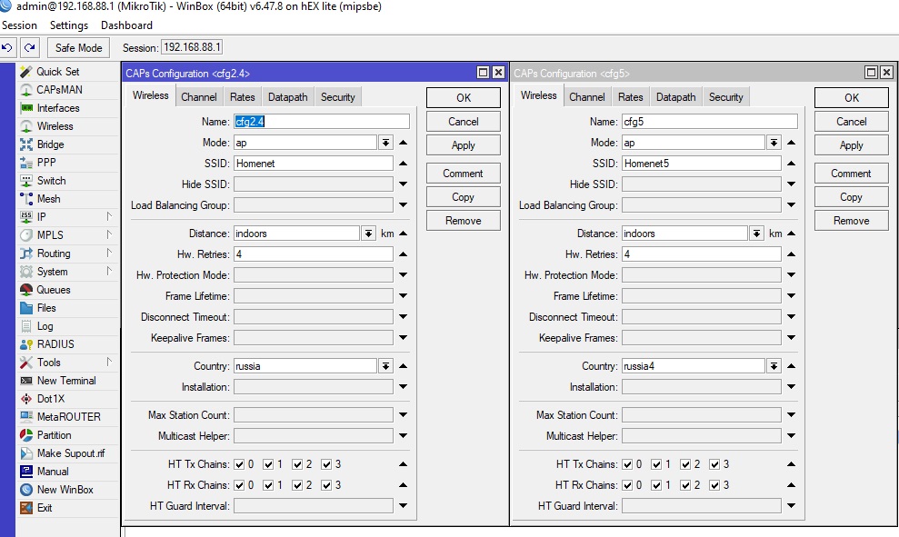

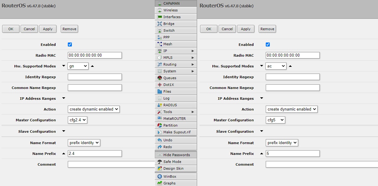

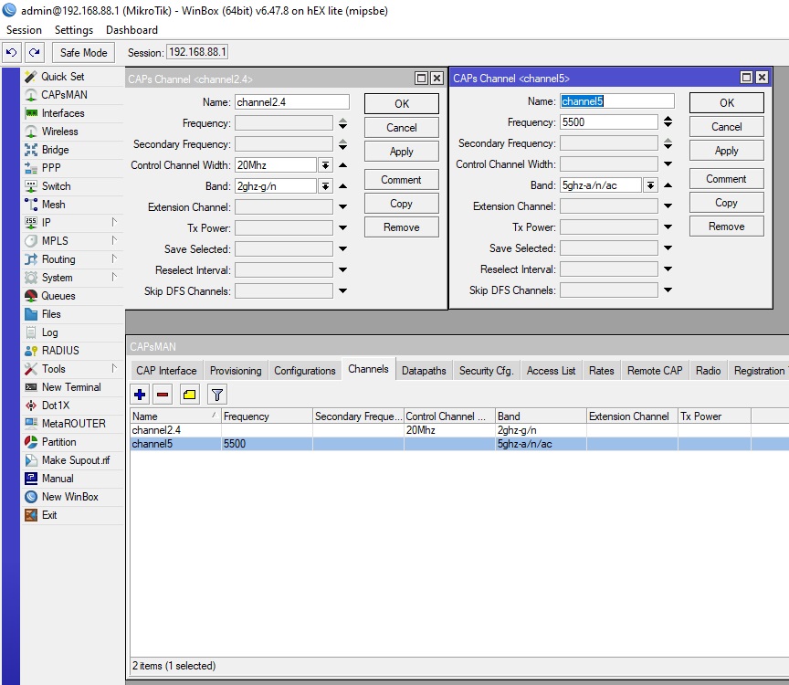

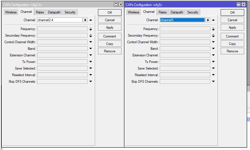

Hello. set up according to the instructions, does not accept settings for 5g
log:
cap2: failed to select channel, no supported channel
my config
https://www.youtube.com/watch?v=taQ70m0DVYA
if done as in the video, 2 and 5 works but with the same ssid
I want its own config for each frequency
