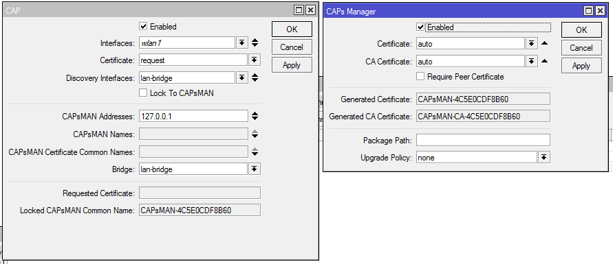

I have installed capsman2 and a working configuration to manage the wlan. If I initialize Capsman2 again, the certifications I delete before, I can register the wlan1 problem-free at capsman2. It also works everything. This messages is in log:
When I restart the mikrotik I get the following error messages and the wlan does not work anymore:
My Settings:
what am I doing wrong?
thx
Rosi
