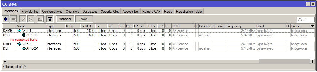

What I have at CAPsMAN in result if I have two Provisionings:
TAB Interfaces:
DSMB AP5-1 (it is 2GHz wlan and it’s working good and Frequency shows as 2412MHz)
  • no supported band
    DMBI AP-5-2 (it is 5GHz wlan and it’s NOT working and Frequency shows as 2412MHz too)
    What I have at CAPsMAN in result if I have the only Provisionings with cfg-2GHz as Master and cfg-5GHz as Slave Configuration):
I have 4 interfaces in CAPsMAN (see screenshot enclosed). And again, 5GHz is not working, marked “- no supported band”)

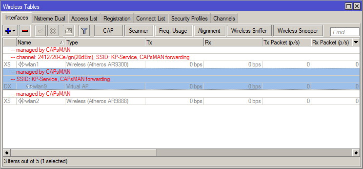

At wAP-ac in this case I have some weird situation with “virtual AP” that I not created. (see next screenshot)

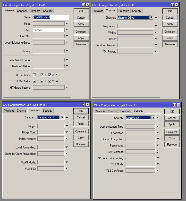

    1st: cfg-2GHz-lan1 with SSID “Service” for main 2GHz APs that would be in the same network with bridge-local of RB3011 (ether2-ether5, sfp, network 192.168.1.x)
    2nd: cfg-2GHz-vlan200 with SSID “Office” for Virtual 2GHz APs that would be in VLAN200 network with bridge-vlan200 of RB3011 (network 10.0.200.x)
    3rd: cfg-5GHz-lan1 with SSID “Service” for main 5GHz APs that would be in the same network with bridge-local of RB3011 (ether2-ether5, sfp, network 192.168.1.x)
    If you want you may add Virtual APs to 5GHz APs too
    Don’t forget to set corresponding CHANNEL, DATAPATH, SECURITY that we created in previous steps for each configuration.

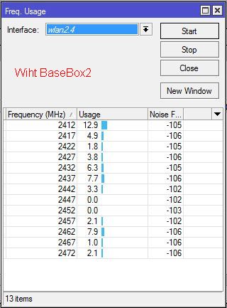

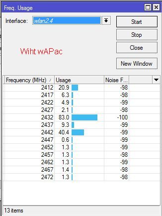

To verify my doupt, I also experienced some strange behaviour when I did a “Frequency Usage Test” on the devices 2.4ghz Modul. It shows, that the frequencies 2432 to 2447 seem to have high usage levels, like more than 60%. Even there is no device around sending in theese channels!!! When I do the same frequency test with another device (not wAP ac), these frequencies have almost 0% usage!!!
