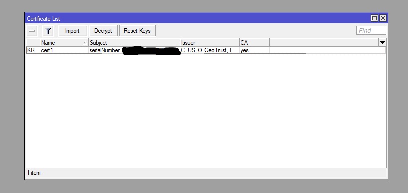

Could you explain how did you installed the intermediate certificate?
Is it installed just like the server-side certificate?
Yup, just import it.
