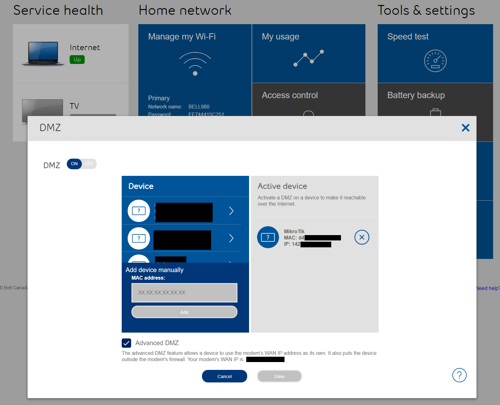

Thanks everyone for the suggestions. I’m posting this so someone else can find the likely answer.
After getting frustrated with it, I let it marinate for a while and just shelved the router again.
Doing further research, I discovered a few accounts of just rebooting the router and the Bell HomeHub (3000). Some users said this might take a try or two to get right, so I did.
Leaving the MikroTik online, I rebooted the ISP gear a few times, checking if DNS worked on the MikroTik each time.
Default config, no changes at all.
HomeHub has the MikroTik set as being in the DMZ, using Advanced DMZ mode so that it gets the assigned IP.
Reboot the HomeHub router once or twice, try Ping each time.
And now it works. Screenshot of HomeHub settings attached.
