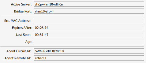

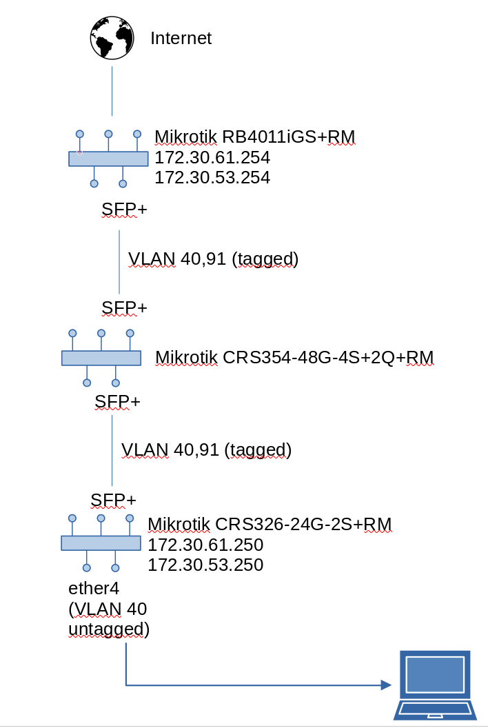

Hello! I have:
  • DHCP server on MikroTik RB4011iGS+RM
  • DHCP relay on MikroTik CRS326-24G-2S+RM (ROS)
They are both in 2 VLANs: 91 (management VLAN) and 40 (workstation VLAN). My goal is to have information about switch and port client PC is connected in.
If I just set up relay, it work perfect. But if I add option 82 to bridge settings on both RB4011 and CRS326 - DHCP stops working (no errors in dhcp server debug log). Tried ROS 7.7 and 7.10 since ROS is very unstable in version 7.
What should I do to fix this?

Are you sure all the right interfaces marked as trusted? What about CRS354, is there no DHCP snooping there?
No, I’m not sure. Tried to mark other interfaces trusted with same result. Without option 82 relay works without making any port trusted.
It is:
add add-dhcp-option82=yes dhcp-snooping=yes ingress-filtering=no name=bridge \
    pvid=91 vlan-filtering=yes
CRS326’ VLAN setup is wrong in multiple aspects:
  1. bridge itself should not have pvid set (to 91) as you’re using VLAN interface (hence bridge should be set as tagged member of said VLAN)
  2. VLAN interface vlan40-bridge-if (anchored off bridge) should not be added as bridge port (you’re creating a twisted loop here)
  3. setting pvid on bridge ports with frame-types=admit-only-vlan-tagged (sfp1 and sfp2) is unnecessary and clutters readability of configuration export (although it doesn’t change the way those ports work)
Both devices have convoluted setup and thus prone to contain errors. RB4011 is even worse, but I’m not going to dive into that mess …
And using CRS326 as a router/firewall is really a sin.
I guess both devices would benefit from upgrading to 7.10.1 (unless you have a good reason not to), there were numerous fixes included in recent ROS releases (your CRS shows 7.7 as version running).
The corresponding interfaces on CRS354 need to be marked as trusted as well. Overall untrust access switch ports that lead to clients, then trust all ports on the way to the router, including intermediate switches with dhcp snooping enabled.

Yes, an obvious mistake, thank you.
You are completely right again, but that complexity and misconfig is the only way I can get necessary functionality: different arp settings for different VLANs and different bridge filters for them.
DHCP relay is not big load, isn’t it? I don’t use CRS326 as router/firewall in another aspects.

SOLVED.
Conclusion: everything I need is not relay, just 3 things:
  1. Add DHCP option 82 in bridge settings on both CRS (not 4011).
  2. Add SFP vlan interfaces on 4011 as trusted.
  3. Add SFP port on CRS354 leading to CRS326 as trusted. Why? After adding option 82 fields request considered as relay? Relays are disabled in DHCP servers settings.
    No relays configured. Now I can see device and port DHCP client connected to.
