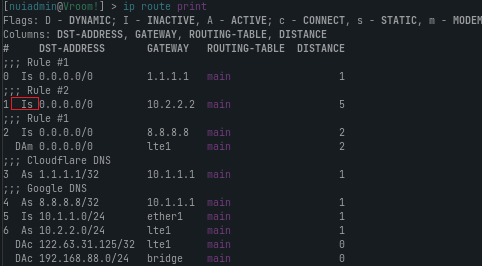

I’m testing this on a Chateau LTE6 device. I have removed ether1 from the bridge and assigned it as WAN (along with the existing lte1). I’ve also set up a DHCP client for ether1, and, because NZ providers insist on running vlan10 over WAN, I’ve also included that.

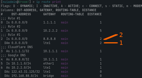

When an active LTE connection is present, it rightfully shows the provider’s public IP, but also adds another entry I’ve labelled ‘1’ on the pic above.
My concern is that this entry might conflict with what I’ve labelled ‘2’, because both have a distance of 2 and ‘1’s distance can’t be changed. I hope this makes sense.
‘1’ disappears when the LTE connection has been disabled (along with the public IP), but returns when re-enabled.
Thanks in advance.
You can try to increase the value of default-route-distance in your /interface lte apn profile, or turn off add-default-route on the profile.
  • add-default-route (yes no) Whether to add a default route to forward all traffic over the LTE interface.
  • default-route-distance (integer; Default: 2) Sets distance value applied to auto-created default route, if add-default-route is also selected. LTE route by default is with distance 2 to prefer wired routes over LTE
Thank you @CGGXANNX . Much appreciated. I’ll have a decent read of that document. I’ve raised it to 3 now. Should this now work once I plug into fibre on ether1? And then swap over to lte1 when ether1 is unplugged? Cheers.

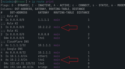

If you intend to have your future WAN (on ether1) as the main internet connection, and lte1 is failover then you can set default-route-distance=3 or higher like 10 and it will be enough.
But these entries should be removed too:
Because lte1 is failover for when the main WAN fails, you don't need to setup checks with recursive routing for lte1.
Beside that, if your main WAN will be on vlan10 like you wrote, then the current route using ether1 is not correct. You will have to create a vlan10 VLAN interface on top of ether1, then in your static routes you should refer to vlan10 instead of ether1.
Does this make more sense…
I’m puzzled now. If the fibre on ether1 drops out, how will will the router know where to find lte1 now it’s IP 10.2.2.2 doesn’t exist? Or does it somehow know where else to find it?

Yes, like this. Of course in the future, once you have your fiber connection, you will need to adjust the 10.1.1.0/24 and 10.1.1.1 values in your static routes to match the gateway and subnet provided by the fiber ISP.
The 10.2.2.2 address is not needed for lte1 (and is probably also wrong). If you look at your old screenshot where you had the 10.2.2.2 recursive check, notice that the check didn't work anyway. The route has the I (inactive) flag:
Because 10.2.2.2 is not an address that you can reached via the lte1 interface (I assume you copied that from the video example?).
What currently really active, is the default route:
And I assume you currently have working internet connection through LTE? In your case lte1 (similarly to pppoe-out1 with PPPoE) is like a P2P link, the gateway is the other side of the link and doesn't need to be specified with an IP address like with DHCP. The gateway being lte1 (or pppoe-out1) is enough.

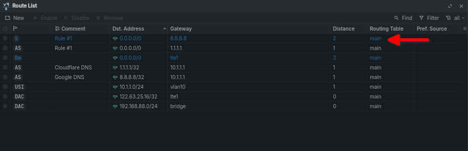

Is the 0.0.0.0/0 8.8.8.8 part supposed to be working? Or is that just monitoring for when the fibre is reconnected? Am I wrong in assuming blue text indicates a working route?
Cheers.
Hmm. Maybe need the full config to say for sure... Since you don't have fiber, it's routing via vlan10, not the eventual ether1 which may still be going out LTE since it may still be NAT masquerade'd. But need to config to say anything definatively.
You can look at /ip/firewall/connections while pinging something other than google/cloudflare. That will show the connection and IPs involved.
Also using /routing/route print is more accurate than a WinBox4 screenshot (since it does not always update state quickly). You might want to post the output of /routing/route print and make sure the terminal window is wide, so all the field like intermediate gateway is show
No, it means it's inactive route, so blue means not working
