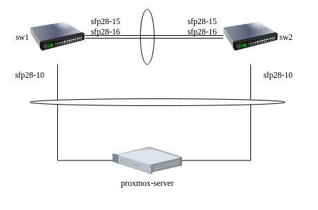

Currently I am facing the following problem: We are using two CRS518-16XS-2XQ switches in an MLAG configuration. Both switches are running on RouterOS 7.2.3. Connected to the switches are three servers running Proxmox VE 7.4-3. The servers are bonding two of their SFP28 interfaces each in 802.3ad (“layer2” hashing policy) - i.e. one bond for Migration of VMs, one bond for Ceph and one bond for corosync.
I attached an image of the setup (with one server only).
The MLAG seems to be established successfully but running iperf3 between the servers yields just around ~450 MBit/s:

When I directly connect two of the servers I get the full 25G over iperf3. The output of “/log print” also show, that the interfaces come up with the negotiated speed of 25GBit/s.
I am grateful for any insights or possible ideas from your side.
Best regards,
Alex
Update:
If I remove LACP and connect two servers to just one switch (i.e. no MLAG no LACP etc.) I also jsut get ~ 450 - 470 MBit/s. I disabled Autonegotiation and set the ports to 25GBit/s Full-Duplex.
Anyone else facing this problem or found a solution? Or has anyone successfully saturated the full speed on this make of switch? I am at a loss here.
