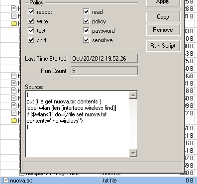

Loot at the file attached. I’ve also inserted the line you suggested me.
It doesn’t work fo me.
I’ve tried without this line
put [file get nuova.txt contents ]
but nothing’s changing.
Look that, file already exists!
first paste in your terminal this
local wlan [len [interface wireless find]]
if ($wlan<1) do={/file set nuova.txt contents="no wireless"}
if the output is nothing, is all ok
and see the comment in the file with this
GOT IT!
As my RB750GL doesn’t have wireless package enabled, “wireless” command does not will be recognized!
I’ve enabled the package and all is working fine!
