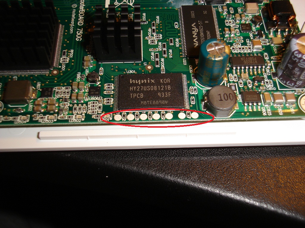

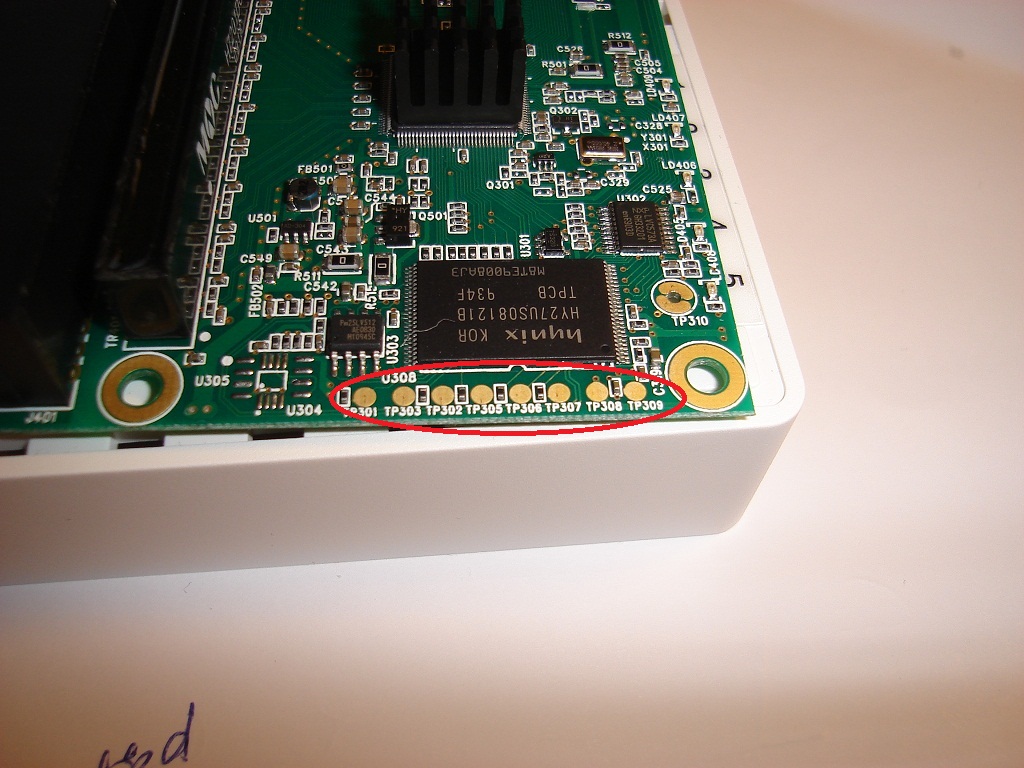

I’ve managed to make not one but two RouterBoard 750 (one 100Mbps and one 1Gbps G-version) into paper weights and according to all the docs I can find on the wiki, I need the serial console to them back into a working order. Unfortunately, this model does not feature serial ports.
Is there any way except serial ports to replace the OS? Only one is bricked because of bad firmware upgrade, the other does not have any IP-address on the LAN-side, and administration is blocked from the WAN-port.
Opening the box, I could find a couple of different testing/soldering points, so I’m hoping that two of these are RX and TX, either TTL-levels or RS232-levels. Attached are pictures of the points.
Of course, I would be much happier if I didn’t have to solder on the circuitboard, and some other solution was available.

Those points on the board are definitely not serial, as that would show up in winbox even without the serial port connector. They are more likely something like jtag or lpc to program the flash at the factory.
If you look at the components, there is no max232.
So if it was serial you would need a TTL converter.
