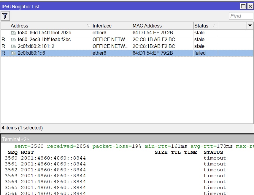

Hello, I did so but still it is same.
I am having the same issue.
. can anyone advise pls?
