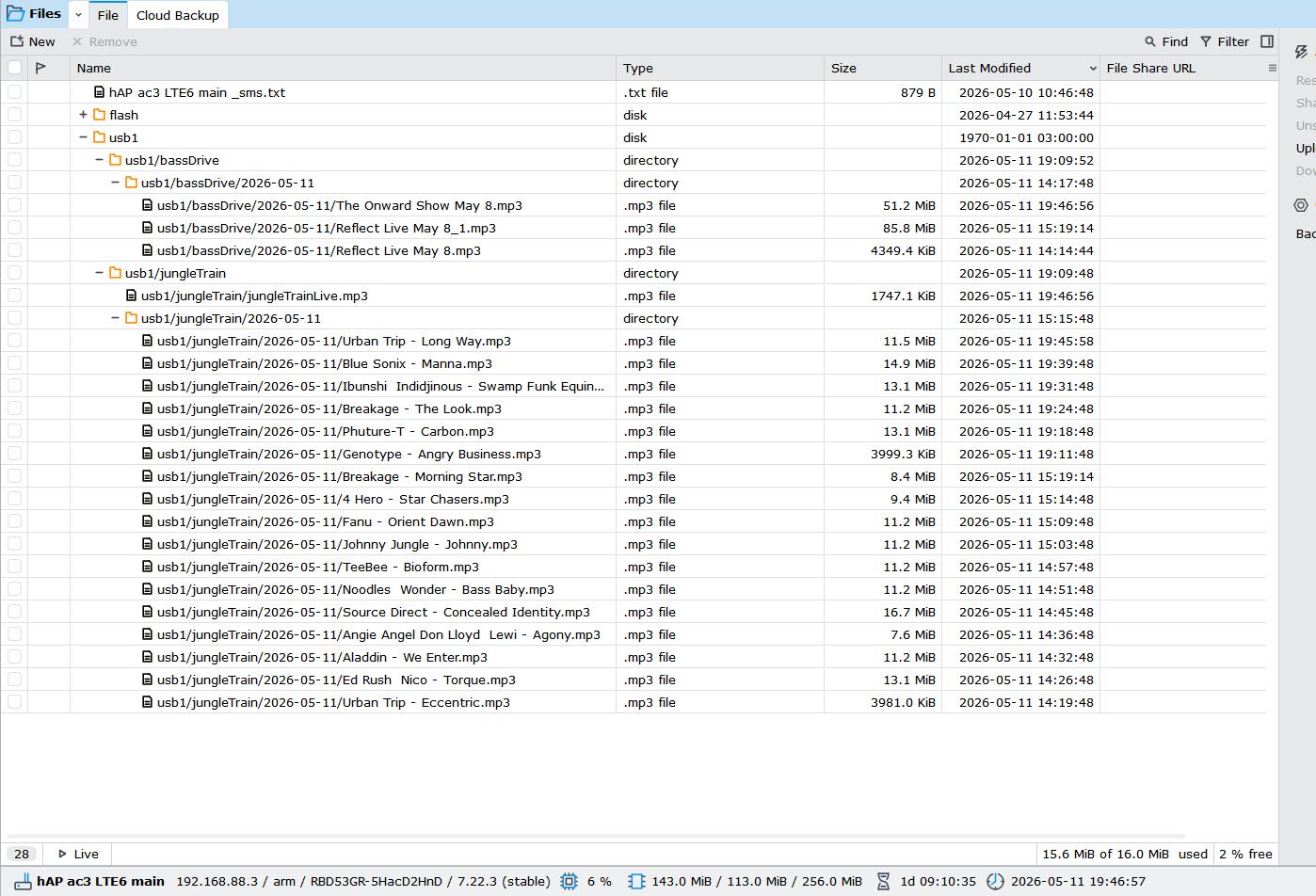

These are two scripts: one a recorder and the other a manager. They record online radio. In the first script, you need to paste a link to your radio stream. In the second script manager, in the block responsible for the current song title, you need to:
  1. paste a link to the endpoint from which you can get the song title.
  2. parse the song title from the response, either manually or with AI. There's an example with subtitles on YouTube.
Oh, and you'll also need a FAT32 flash drive.
The script manager needs to be run in the scheduler, every 5-60 seconds, depending on how precise you want the song cuts to be.

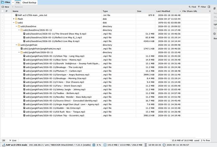

The scheduler starts the manager, and the manager starts the recorder. To stop recording, stop the scheduler and delete running scripts in Scripts/Jobs.
The result will be something like this
