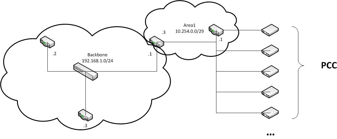

I will explain my scenario, I have a OSPF route network with a two areas. In the backbone area are routes connected in 192.168.1.X/24 network and area1 has 10.254.0.X/29. Backbone area is for routers running as NAS and within area1 are a router for PCC Balancing as you can see in attachment.
So, everything is ok, I have conectivity to all devices in this enviroment; the problem is when I want access to router balancing, Winbox doesn’t open, ssh too, but ping it’s working fine.
For record, Winbox shows me error “could no get index: fatal error” and ssh shows me “ssh_exchange_identification: Connection closed by remote host”.
Now, what can I doing wrong?.

Do you have loopbacks setup and are you trying to access the routers via the loopbacks?
