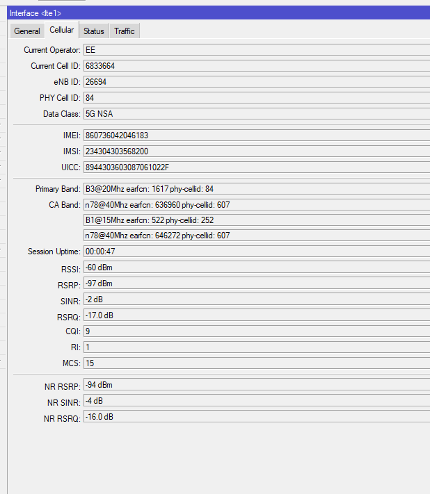

  • If I’m forcing my router to use LTE and NR on band 3, I’m getting internet
  • As soon as I’m removing any band restriction on NR, I can see that he is trying to registered to another tower and I’m loosing internet

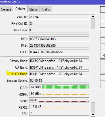

The only notable difference between the two scenario is coming from the UL CA band being registered when using a restriction and band 3 but not when restrictions is revoked. I tried to lock my LTE interface to a 5G cell tower using the following command in Modem Init but it doesn’t work. (I’m not sure that this command is made for Chateau, on the documentation it is listed under R11e-4G)
AT%CLCMD=,,,,
Missing UL CA band (no internet)
UL CA band present (internet)

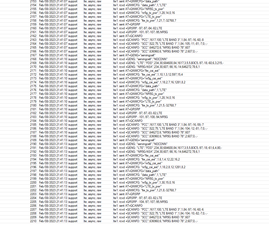

LTE logs when internet is down
Sup-output available here:
supout.zip (291 KB)
why do you want to restrict the bands?
in NSA it is risky to restrict the bands, as the 5G and LTE work in certain combinations, depending first on the operators base station bands and then on the device’s capabilities.
in case 1 you have only LTE. It seems there’s no NR in band 3. The base station provides 2 different carriers in LTE band 3 and you get UL CA.
in case 2 you restrict the LTE band, but not the NR band. Please try without restricting the LTE band.
