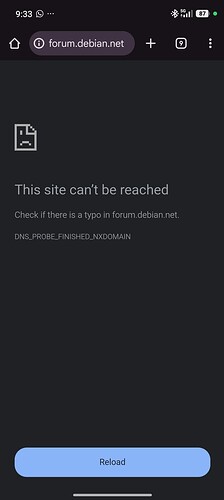

I tested forum.debian.net at the office and also I’m unable to resolve it. Also tested on my mobile phone connected to the 5G so no wireless connection is enabled and I get the same thing.
It seems that there is no problem with your configuration but with this website.

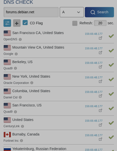

DNS Checker - DNS Check Propagation Tool.
You can use this site to see if it's a local or global DNS problem. As you can see forum.debian.net doesn't exist.

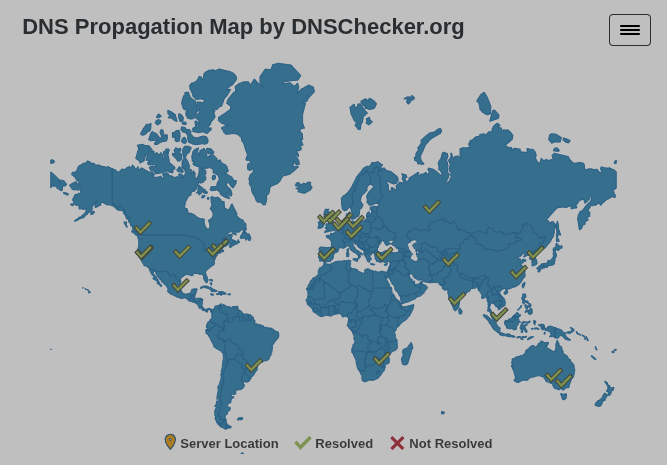

And here is the result for the correct forums.debian.net domain: DNS Checker - DNS Check Propagation Tool.
That's the one I used.

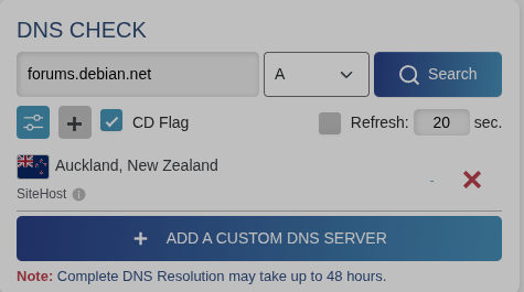

So, that looks good for the site but I note there are no dns servers listed for NZ, where I am.
You use OpenDNS ... yes ?
What NZ based DNS servers would there be then to use ?

I’ve tried to add a few DNS servers but all get refused.
When I ran the worldwide test, it came out all ticks -
Maybe I read this wrong, but if they all resolve, doesn’t that mean the site is good?
