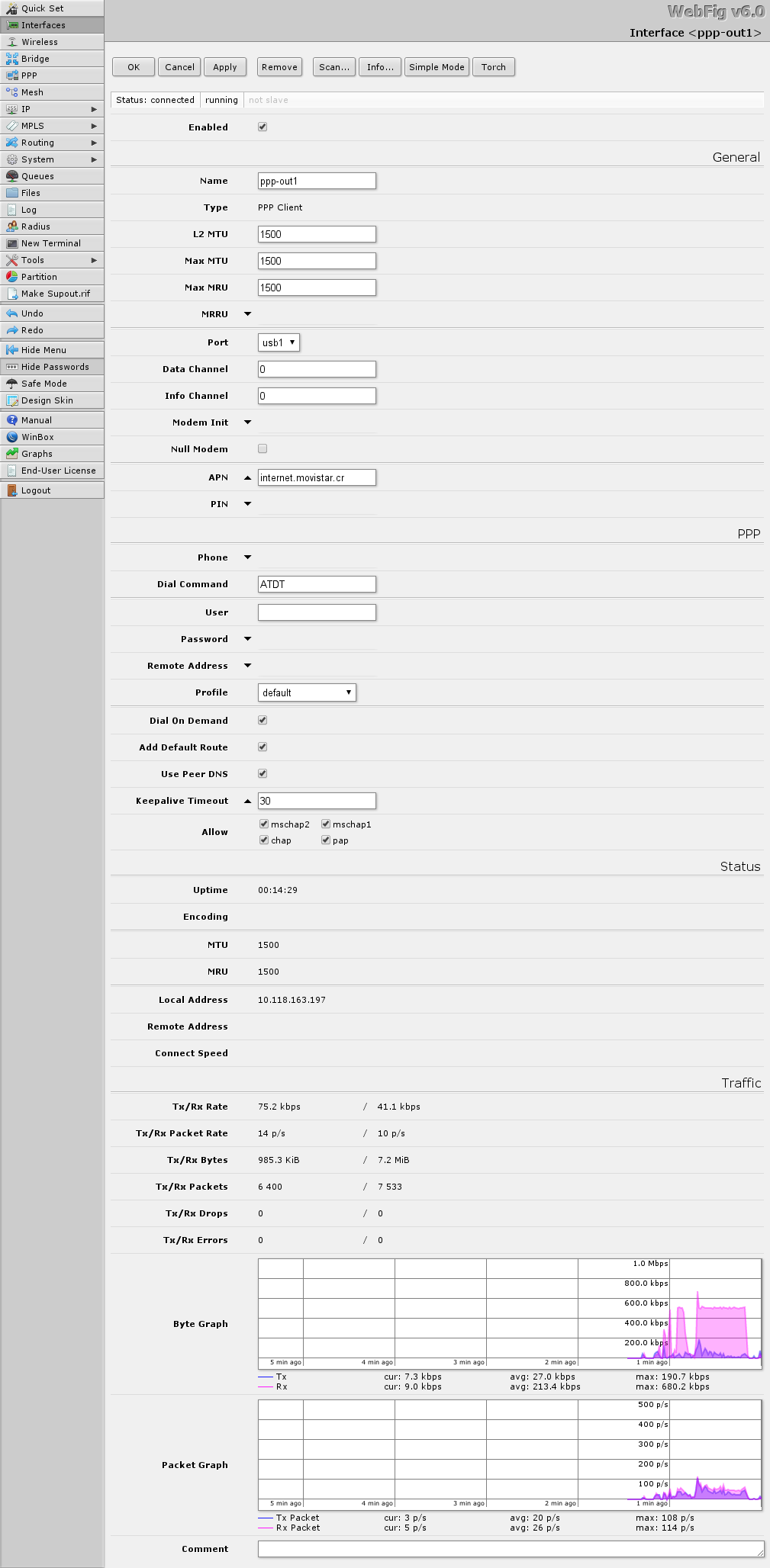

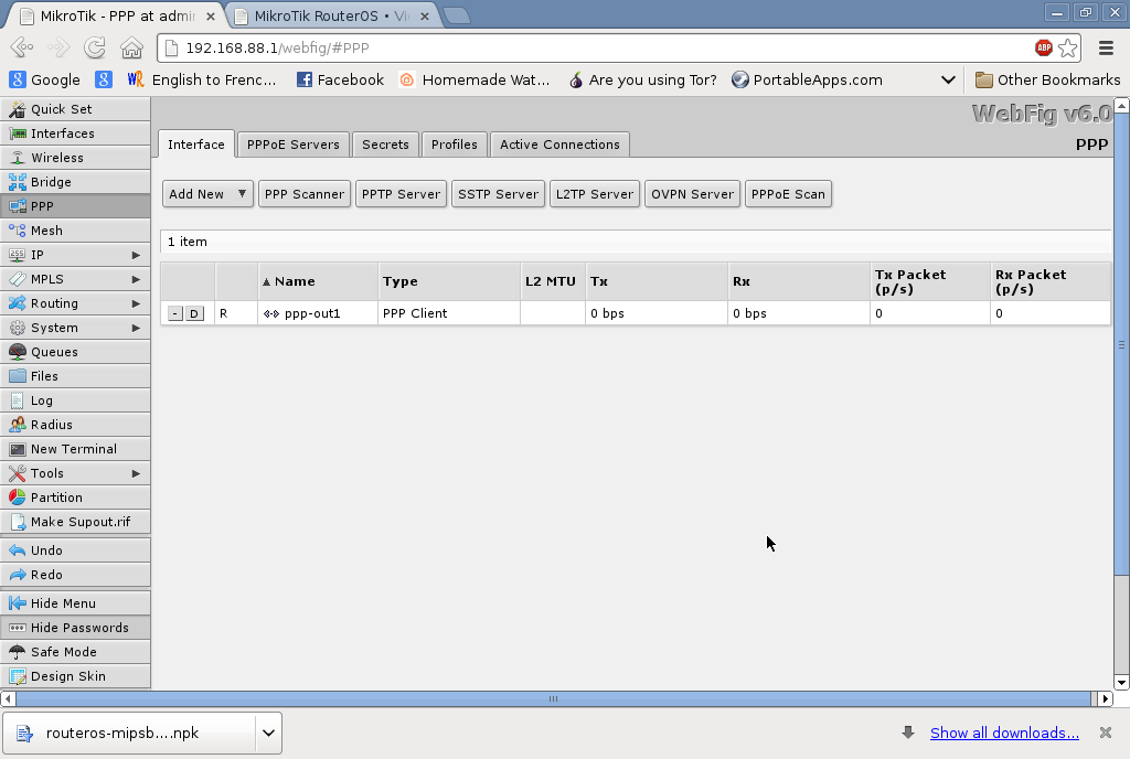

could you show me the ppp client general tab and ppp tab, thanks.
Sure!!
As a matter of fact I’m posting this using the very same card
Please make sure you’re using the right APN, a few days ago I was setting up another Mikrotik for a customer and all connections were dropped, after a couple hours of debugging I figured it out that the APN I was using for that specific ISP was not the one I needed
