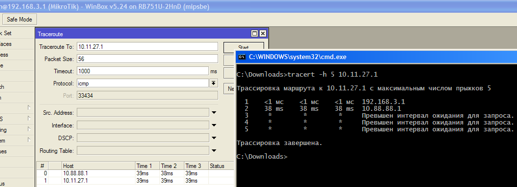

Check the routes on your home PC and also run tracert to a work LAN address and see what path it shows.
What route I have to have on my home PC?
route add -p 10.11.27.0 mask 255.255.255.0 192.168.3.1
It didn’t help.
I’ve got “Request Timed Out”
The trace route should show you how far the request is getting before it times out.
From router’s terminal everithing works fine, but from PC - nothing.
I’m not shure what route I have to add.
What is the default gateway set to on the device you are pinging on 10.11.27.1 ?
There is no gateway on that PC. That is DNS of that network.
Work router is connected to network 10.11.27.0 and 1 PC has 2 NICs (10.11.27.* - work LAN and 192.168.1.* for the internet).
I don’t know how it was configured, but internet goes to 192.168.1.0 network. 11… network has no internet. Fromoutside I connect to 11… network through PPTP on the router.
