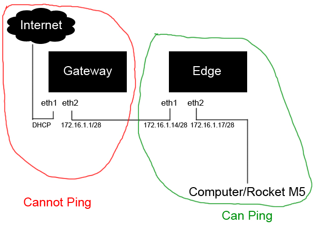

draw a simple map to specify what is “pingable” and what isn’t..
Regards
Sorry, I should have clarified that. The RB450G won’t seem to route 172.16.1.0 to anything connected to it (I can’t ping that network from my computers),
but the router itself is able to ping that network using the built in ping utility.

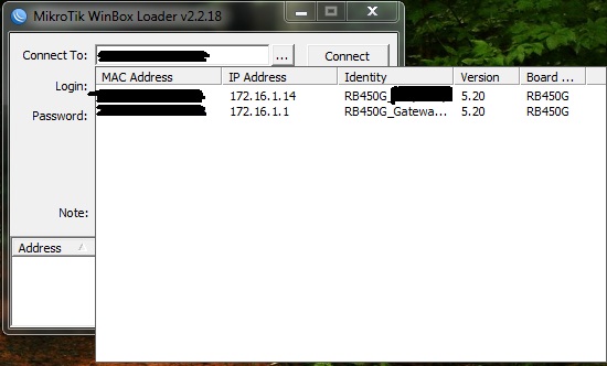

Apparently Winbox is able to discover both routers though.
Also, It seems that when I plug my computer into the gateway router it can ping the edge now, but I can’t ping the gateway when connected to the edge.
Solved now, routes were needed in the Gateway to reach the edge but a reboot was also required before they would function
