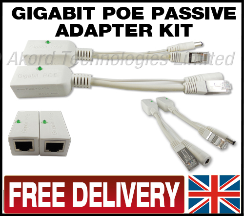

Thanks. Found this PoE set on eBay, pretty nice priced:
http://www.ebay.com/itm/200853152137
Hope it will work with my RB751G-2HnD, using the injector only. If not, I will use both the injector and the extractor.
Guess what, it works perfectly with my RB751G-2HnD, using the injector only.
And !!! it’s possible to use both parts as PoE injectors ! Just use a DC female-to-female adapter on the PoE extractor side, and voila: you’ve got two gigabit PoE adapters compatible with Mikrotik. :laughing:
For that price (5 GBP /pair), it’s a real bargain.
