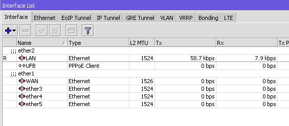

RB750 with brand new setup.
Following basic config, the RB750 (running v6.34.6) can connect via a PPPoE connection on fibre and appears to correctly assume the connection’s fixed IP and pick up the DNS servers.
Via tools on the router, using WinBox, I can ping google.com and perform traceroutes, no problem.
On the client, via DHCP on the LAN port, a LAN IP (17.16.10.200) is assigned, with 255.255.255.0 subnet and router at 172.16.10.1 (DNS is same IP).
However, the client has no internet. From a terminal I can nslookup OK (e.g. google.com → IP#) but nothing else.
I feel like I’m missing something pretty basic, but can’t figure out what it is!
Any help much appreciated. I have attached a few screenshots.
Thank you!

Check your NAT rules.
I could bet the default masquerade rule has ether1 (WAN) configured as out-interface.
Switch it to your PPPoE client (UFB)
It should look like this:
add action=masquerade chain=srcnat dst-address=0.0.0.0/0 out-interface=UFB
-Chris
Hi Chris
Thank you for the prompt and super-helpful reply. You were correct! I’m up and running now.
So the NAT rules (and I guess, the filters) need to be applied to the (virtual) interface itself, being the last “link” (I could be guilty of mixing terminology here that has special meaning elsewhere)?
Best wishes
Robin
