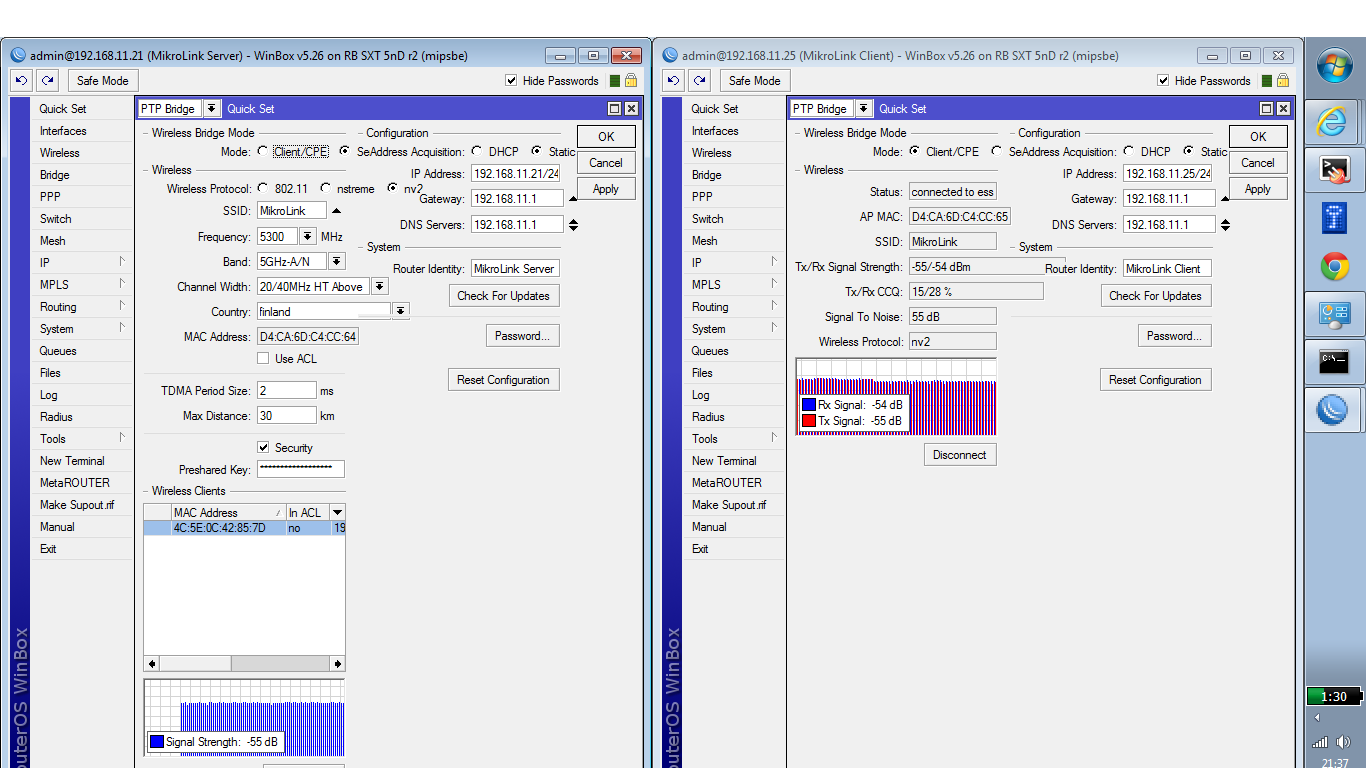

Assuming that the server side is ok, I tried resetting the client side and have my laptop connected here. So I connect to default address 192.168.88.1 with WinBox and let the default configuration be.
Now lets give a shot to “Quick Set”. I switch the mode to “PTP Bridge” Client/CPE and now I get the server side SSD listed in a window below - great! Since I have set nv2 to use secure connection, I type in the WPA password and hit connect.
Odd enough, the link does not set up. Wireless status remains to be “searching for network”. That’s not good, so I goto see the settings in Wireless → Interfaces and open the wlan1-gateway. Under NV2 tab the “Preshared Key” field remains empy and “Security” checkbox unticked? So I type in the WPA password again and tick the “Security” and apply the settings. Now I can see the link has been established! Rock on!
At this point I open a new instance of WinBox and let it search for devices. Although rest of my network resides in a different subnet, it can still find my main router and server side SXT. So it’s all ok now?
Now I want to have the client side SXT to use the same IP address space with rest of my network, so I change it to a next free address (via “Quick Set”) and hit OK. Obviously WinBox disconnects and I have to change my LAN adapter address to reflect this network settings.

Well, although there seems to be very little of help available, I finally made it work. Not sure how or why, but it is now connected. I didn’t touch the server side anymore, only client. The “Quick Set” seems to do some misconfiguration as I stated previously. Not sure if this is by design, but e.g. protocol was set to “nv2” it will be “nv2 nstreme” under wireless interface settings. I don’t know if this matters though.
The link was up and running almost two days until today it died again. The server side SXT did not make any reply nor was I able to find it with WinBox. Finally I set it to factory defaults and started configuring all over again. Now it’s operating again and I’ll just have to see if it makes this hiccup again. Hope not.
