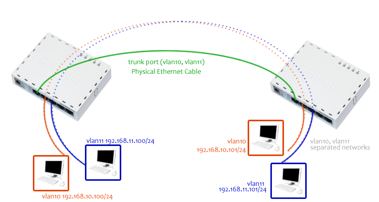

I have two Mikrotik routerboards MT750GL (5 port) with routerOS 5.6. I am trying to pass trunk (vlan10 and vlan11) between two Mikrotik routerboards MT750GL.
To better explain what I’m trying to achieve, i’ve configured my two Cisco switches for the exact task. Is there anyone who could write this configuration for MT RouterOS? Thanks!

  1. By using MikroTik bridging - it is simple, but the trunk must not have a native vlan - all should be tagged. And - the worst part - it consumes CPU and the bandwidth will be low - wasting the gigabit ports. Then:
/interface vlan add name=ether1vlan10 interface=ether1 vlan-id=10
/interface bridge add name=vlan10
/interface bridge port add bridge=vlan10 interface=ether1vlan10
/interface bridge port add bridge=vlan10 interface=ether2
/interface vlan add name=ether1vlan11 interface=ether1 vlan-id=11
/interface bridge add name=vlan11
/interface bridge port add bridge=vlan10 interface=ether1vlan11
/interface bridge port add bridge=vlan10 interface=ether3
/ip address add address=192.168.10.10/24 interface=vlan10
/ip route add gateway=192.168.10.254
The only difference is that both vlans are tagged on the trunk link.

Thanks for your comments. I totally agree with you both, everyone should use dedicated switch instead of MT RB for such task. I just wanted to know, if MT RB could be used for such tasks, where data TX/RX rates are not high and simple VLAN solution needed.
dasiu, i tried your suggested solution and it works like a charm! Although I found a slight typo in your sample code (as far as I understand).
Interfaces “ether1vlan11” and “ether3” should have been added to bridge “vlan11”.
Thanks! :slight_smile:
Yeah, exactly - your understanding is absolutely correct! I just went easy and copy-pasted the vlan10 and changed interface - but forgot to change this (yeah, it was late night) :slight_smile:.
