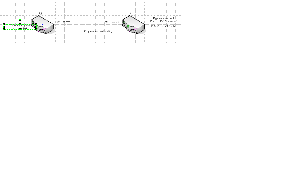

I have two mk routers R1 acting as a edge router and R2 as a PPPoE server.
in R1 there is a eth1 connected to ISP with a public IP(/30) and routing one /24 public IP range.
I want to add a new public IP (95.xx.xx.yy/24) range to PPPoE pool in R2 to deliver public ip to our customers.
R1 and R2 are connected using 10.0.0.1 and 10.0.0.2 private IP. The network is ospf enabled and working.
The problem is that I need a masquerade rule in R1 for get internet access to the pppoe customers in range (95.xx.xx.yy/24). When I disable this rule on R1 pppoe customers can’t access to internet.
Then I do traceroute and the last hop that works is 10.0.0.1.
On R1 there is a static default route working OK and ospf distribute default route and connected routes (if-installed as type 1) on R1 and R2 (all networks in backbone area).
I don’t uderstant why I can’t route the public ip range (95.xx.xx.yy/24) to our customers and when enable on R1 a masquerade rule then works (masquerading eth1 public /30 IP).
I tried proxy-arp on 10.0.0.1, 10.0.0.2 and pppoe bridge(95.xx.xx.1).

As you can see I have doing tests changing private ip by public ones and the result is the same.
Now router 1 has 9x.xx.xx.2 (10.0.0.1 is still active) on a bridge interface
Router 2 has 9x.xx.xx.3 on eth1(10.0.0.2 is still active) that is connected to router 1.
  • PPPoE server on router 2 it’s installed on a bridge interface and its pool goes from 9x.xx.xx.20-9x.xx.xx.254 (this bridge interface has no IP), and his local address is 9x.xx.xx.3
In Ripe NCC database there is the route object created and my ISP says that the route is announced and working (I have another /24 working ok).
I tried to do traceroute from a pppoe client to 1xx.xx.xx.85/30 (the IP from remote router upstream provider) and without masquerade rule on Router1 (Router 2 has neither nat nor mangle rules) the last hop is 10.0.0.1 and is unable to reach it.
