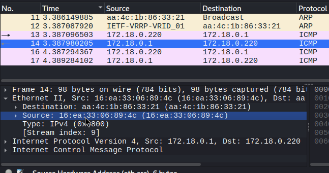

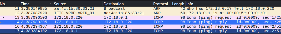

I am seeing the same behaviour as before. I get reply from router with src mac set to interface mac ( except ARP req to virtual IP)
correct ARP response
ping req with correct dst-mac
response with different src-mac
I am not sure is this the expected behavior ? should I add firewall rules in the clients to trust these reply
