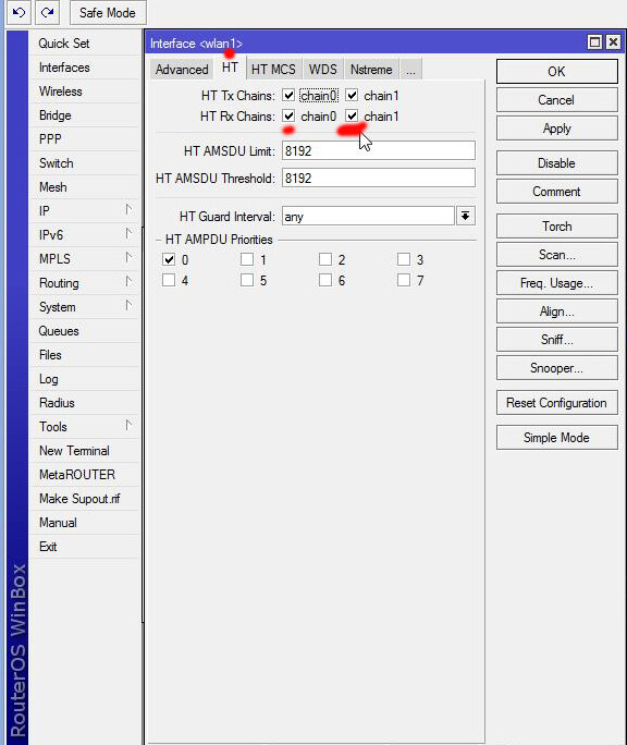

Have you select all the chains by HT?

What do You mean by “Have you select all the chains by HT?” I am a beginner, so maybe I am doing some mistake :slight_smile:
Click on wireless interface, go to “HT”
See screenshot
I have RB951-2n, and i see only Chain0. I suppose, it means, i have only one chain :slight_smile:
Yes, rb951-2n have only 1chain. What say log? Is there any error mesage?
